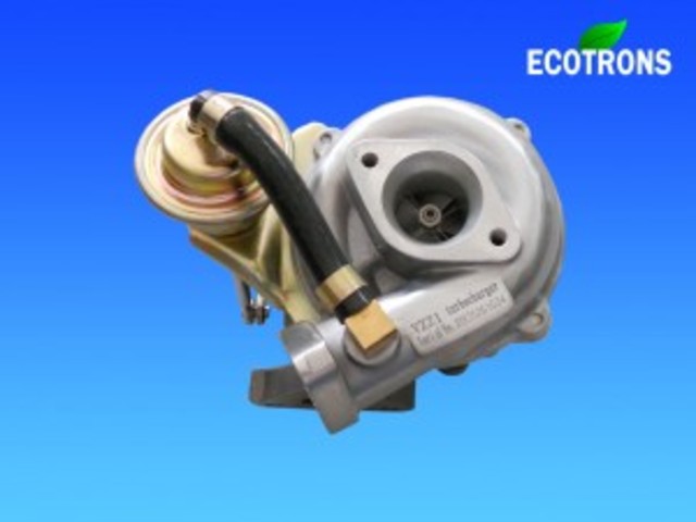

bmsgaffer 2,071 #8 Posted July 28, 2015 well then while your at it:http://www.ecotrons.com/products/small_engine_rhb31_vz21_turbocharger/That should help overcome the flathead limitations..... 4 Share this post Link to post Share on other sites

wrightorchid 261 #10 Posted July 28, 2015 25hp for about $2500 is pretty steep, but I would guess on par, since many of the commercial mowers and such that use these are $6-9K. Share this post Link to post Share on other sites
bmsgaffer 2,071 #11 Posted July 28, 2015 Its expensive sure, but I don't think all that out of line for the engine size and technology. Those are 'top of the line' engines that use less fuel than a much lower hp counterpart and can start quickly in almost any conditions. Very tempting when repowering.I would like to see how efficient you can make an Onan P220 or K-341 with that EFI conversion (with turbo? ) but you are talking some $$$ for that and you hopefully will have an engine that's not worn out already to put it on!What I DO see happening in the not too distant future is a plug and play EFI kit for the HF 22hp predators. That would be a pretty slick setup and with a few internal upgrades to have a bolt on turbo.... Share this post Link to post Share on other sites
