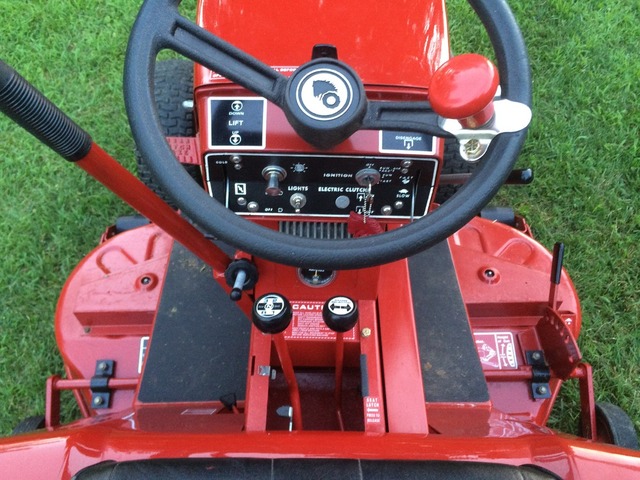

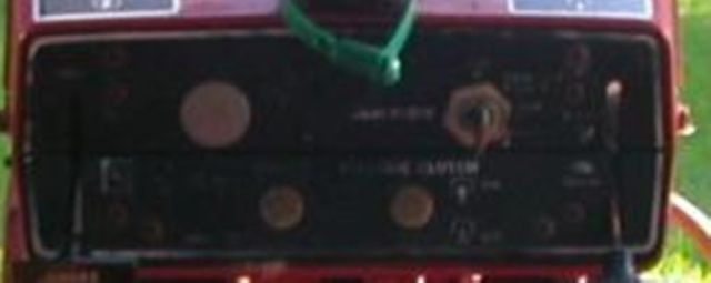

I restore the panels for my restorations and have done a few for members of RS, and have written a rather easy to follow procedure for doing them yourself. Article and examples below. Even if you found an old nasty, but unbroken one, you could get them to look like the examples below by following the process in the article. :)
ARTICLE
http://www.mywheelhorse.com/modules.php?name=docs2&do=show_doc&id=1
LATEST DASH RESTORATION EXAMPLE
