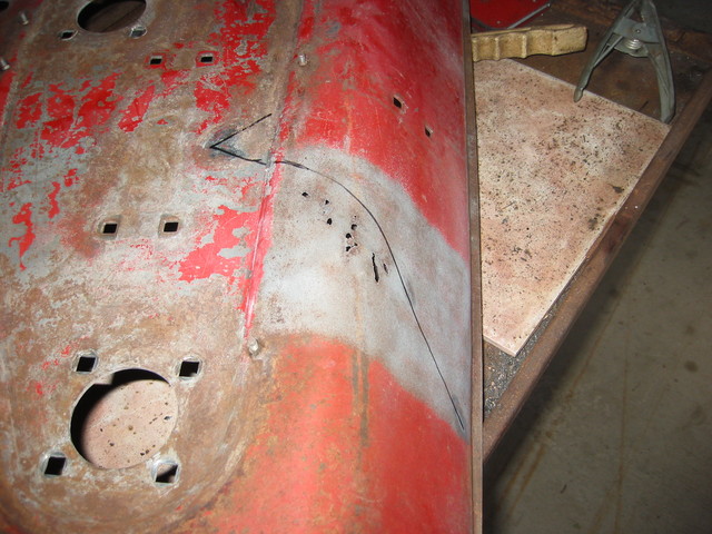

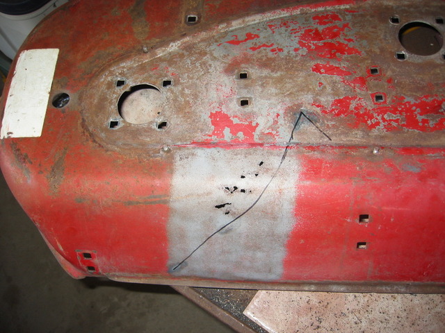

pfrederi 21,274 #1 Posted July 21, 2015 I need to make some repairs to a deck that came with my newest horse Charger 10. I want to put a patch over the small holes in the picture. The metal between the holes has been significantly thinned by rust so I want a single patch that will provide some support. The black line shows where the baffle under the deck is. Because of that i will have to patch on the outside. The deck shell is 1/8" thick steel. I have some 1/8" stock but I have no clue on how to bend it to match the curve of the deck shell. I would start the patch at the small dip for the belt drive area so I only have to get the large radius bend Share this post Link to post Share on other sites

pfrederi 21,274 #8 Posted July 21, 2015 I would clamp the flat to the side then heat the plate to form the bend to the deck. I use a small plumbing torch with maps gas. This is how I did it for our latest deck patch/repair. I agree.Also cut out the rotted material and lay the patch flush in the hole.Weld and grind smooth. That certainly would be nice ..but the baffle underneath plus my lack of metal working skill combined with the fact there is an external patch on the other side of the deck...How does one go about cutting out the deck to match the patch??? Share this post Link to post Share on other sites

DennisThornton 4,773 #12 Posted July 23, 2015 Looks like you've put a lot of time into it already so I'm guessing you want to do the best, longest lasting repair that you can. Take a torch to it, playing the flame over the bare area gently at first and heat while checking for changes in color to small spots. The good thick area will hold it's color while the thin ready to rust through needing to be patched areas will turn straw and then blue. You'll have a better idea of how big to make your patch while limiting your work by using the smallest patch possible. Then make your patch. Don't cut until you have your patch ready! Use some heavy paper to make a pattern thinking about how you will make your bends in the sheet. No point in making a big one piece complicated pattern if you can't bend and make it in sheetmetal. You might consider doing some of the bending before you cut your patch since you might have more to grip and better leverage. A vise, pliers, hammer and an anvil, big chunk of steel or pipe will be very handy, but you can use the edge of a workbench or edge of your deck or steps and a length of 2x4 and clamps. Whatever it takes with whatever you got! Bend, heat and bend, pound with a backup, block of wood or even sand or dirt. Then test fit your patch to the still uncut deck. You can even do a bit of finish shaping using the deck as the backup. Clamp it in place, hammer, heat the resisting spots and hammer some more. When you are happy with the patch mark around the edges and cut out the bad area. Tack weld corners and edges first until it is locked in place hammering out any distortions as you go. Use a metal dolly or another hammer to support your work from behind. Then fill in your welds and grind. If you shaped and hammered well you'll have less work now. If you didn't then hammer, heat and hammer some more. Any bad spots are still fixable.Good luck with it!Dennis Thornton 2 Share this post Link to post Share on other sites

DennisThornton 4,773 #17 Posted July 24, 2015 I would clamp the flat to the side then heat the plate to form the bend to the deck. I use a small plumbing torch with maps gas. This is how I did it for our latest deck patch/repair. I agree.Also cut out the rotted material and lay the patch flush in the hole.Weld and grind smooth. That certainly would be nice ..but the baffle underneath plus my lack of metal working skill combined with the fact there is an external patch on the other side of the deck...How does one go about cutting out the deck to match the patch??? Indeed overall the deck needs to be strong but not every inch. That area is strong from the support behind. If your metal working skills and tools are limited you could use thinner metal and/or other materials to patch it. You might use whatever thin metal that you CAN manipulate and just solder or epoxy it on. Or even skip metal altogether and use fiberglass and resin. Both would last a season at least or several if you remove all the existing rust. You could even patch mostly from the inside and have far less cosmetic work from the outside. Actually if you remove all the rust (tough where that support is welded to the deck shell...) you could do a pretty good looking and lasting repair with no metal at all! Don't even have to remove the damaged section. In fact, you could leave it to help hold and shape your fiberglass cloth from underneath. Just epoxy resin (thin resin, not glue!) the cloth to the inside of the shell! Then just JB weld over the rusted out areas from the outside, sand and paint.If you are still going to pursue cutting out the area, a high speed cutoff wheel on a 5" grinder (with safety glasses!) is a cheap and usable choice! 1 Share this post Link to post Share on other sites
steve k 82 #18 Posted July 24, 2015 cut your pattern out of heavy paper to get it right then lay it on your metal and trace it. cut out the new patch, find an area you can weld the patch into place then use a torch to heat it and bend as needed little by little all the while welding more into place. Share this post Link to post Share on other sites
