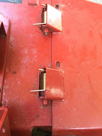

motox25 36 #1 Posted July 19, 2015 A lot of the 60" decks I see for sale are missing the side discharge chutes. Do you guys that have 60" decks run them with or without the chutes? Mine came with a chute and that thing bounces and rattles the entire time I'm mowing. After looking at the parts schematic I found I was missing a couple of springs on the chute. I bought the missing springs and installed them the only way I could see possible but they don't seem to do much to fix my problem, do I have them on wrong? Share this post Link to post Share on other sites
gwest_ca-(File Mod) 12,462 #2 Posted July 20, 2015 There is a good illustration on page 4 of this manual http://www.wheelhorseforum.com/files/file/2160-mower-rotary-60in-sd-1997-1998-78390-om-3318-950pdf/Garry 1 Share this post Link to post Share on other sites
motox25 36 #3 Posted July 20, 2015 Garry, thank you, that is exactly what I was looking for! I was unable to tell looking at the manual for my deck how it goes together. I'm sure people had fun putting those on back in the day, I gave up for tonight after 30 minutes of trying to compress the spring and slide the bolt through. Share this post Link to post Share on other sites

motox25 36 #5 Posted July 21, 2015 Well after 2 hours of fighting I finally got the springs on. And they made it look so easy in the manual Now I can see why I haven't seen a single deck with those springs on! Thanks again Garry! 1 Share this post Link to post Share on other sites
