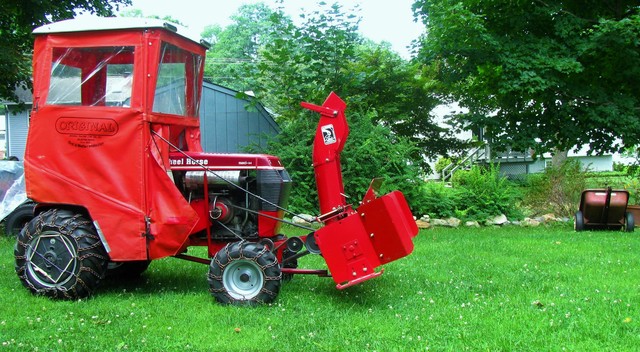

squonk 48,229 #27 Posted July 26, 2015 My Originl Cab has both... snaps, and a zippered bottom, on its replaceable windshield. Ok " Mr. Cab", where do those springs go? Awesome! Just awesome! I need to know how she works in a few short months! Curious about how much the front chains will help. Looks like the rear chains should do a good job even over the ags. I'm a big fan of the double cross links!Dennis Thornton My Originl Cab has both... snaps, and a zippered bottom, on its replaceable windshield. Ok " Mr. Cab", where do those springs go? Spin those frt ag's so they are backwards. It will steer even better. Share this post Link to post Share on other sites

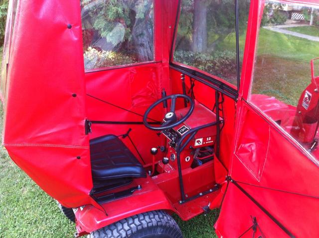

squonk 48,229 #30 Posted July 26, 2015 These springs go on the bottom somewhere to help keep the flaps tight I think. The instructions mention them before you even get to the doors. No pictures of them either Share this post Link to post Share on other sites

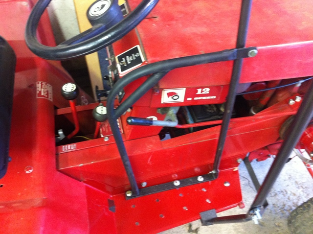

squonk 48,229 #31 Posted September 16, 2015 Custom made brace made to clear PTO lever 3 Share this post Link to post Share on other sites
Theroundhousernr 590 #32 Posted September 16, 2015 These springs go on the bottom somewhere to help keep the flaps tight I think. The instructions mention them before you even get to the doors. No pictures of them either Right on, they are meant to go in tabs in the vinyl on the bottom near the foot rest and get pulled back tight and hooked in somewhere on the frame. I wil have to crawl under mine to see, I dont remember. They keep the material tight against the foot rest to keep air and snow from blowing in on your feet i guess. Share this post Link to post Share on other sites
Fun Engineer 863 #33 Posted September 17, 2015 These springs go on the bottom somewhere to help keep the flaps tight I think. The instructions mention them before you even get to the doors. No pictures of them either Right on, they are meant to go in tabs in the vinyl on the bottom near the foot rest and get pulled back tight and hooked in somewhere on the frame. I wil have to crawl under mine to see, I dont remember. They keep the material tight against the foot rest to keep air and snow from blowing in on your feet i guess. Mine were connected to cotton straps with knots in them that ran through grommet holes on the bottom of the vinyl cover. One end of the spring then connects to what ever part of the tractor that's available and won't interfere with the tractors or implements operations. Sorry, no pictures available. Dave Burley Sent from my tractor seat. 1 Share this post Link to post Share on other sites
608KEB 854 #34 Posted September 17, 2015 The springs secure the cab. There should be some sort of strap near the front of the foot rests. Ill take a pic of my cab and post it for you Share this post Link to post Share on other sites
Don1977 606 #35 Posted September 19, 2015 Some mention fender washers under cab frame mounts on the foot boards and it would be a good idea. I stiffen up my foot board by spot welding a 3/8" rod under the lip. They were bent and gave every time I got on, they don't even give any now. Pictures below. 1 Share this post Link to post Share on other sites

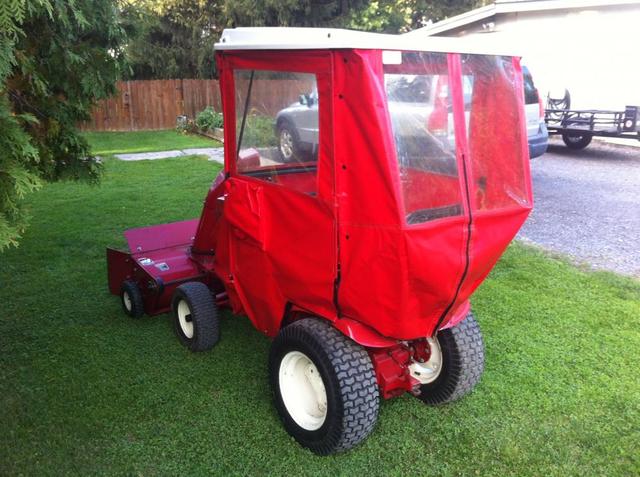

squonk 48,229 #38 Posted September 27, 2015 Cab is all on.Got my gnarly hood on too. Found out part of the left door latch is broken but a tie strap took care of that. Just need to make a 6" extension for the chute control and add the weighted rear wheels chains and 4 wheel weights. I'm a tight fit. I won't be getting in and out of it with my 4WD snow boots on! 2 Share this post Link to post Share on other sites
