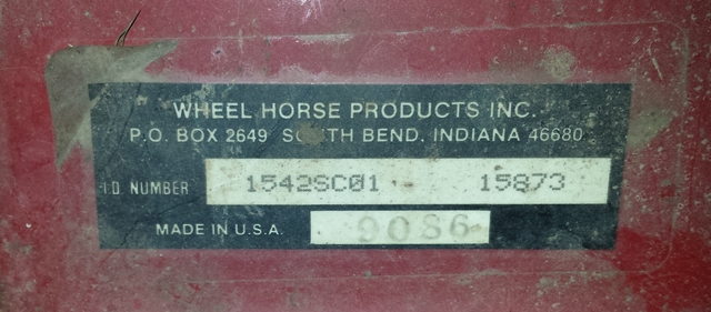

Texas Todd 1,026 #1 Posted July 12, 2015 I have had a 1989 312-8 for some time now. I have never been happy with the cut. The mower deck is 1542SC01. That tells me it is a 42" cut and I have seen on this site where the proper blade kit is 106636. But when I search for that deck number, it shows deck 106637, which is a 48" deck. But that is a 16 1/16" blade. http://www.repairclinic.com/PartDetail/b350p21/Wheel-Horse-Lawn-Mower-High-Lift-Blade/106637/1635430?modelNumber=15-42SC01&ss=a21b350d1036943&mr=1Is where I searched by the deck# and it calls for the 106637.I just need someone to validate the 106636 blade # and blade length. It seems mine are about 13.5", which could explain the missed grass which makes stripes in the lawn. Thanks! Share this post Link to post Share on other sites
gwest_ca-(File Mod) 12,462 #2 Posted July 12, 2015 This is a common problem that computers don't understand. That parts list is from Toro and it is shared with the 42" rear discharge, 42" side discharge and 48" side discharge decks so there is more than one blade listed.Here it is.http://www.wheelhorseforum.com/files/file/2285-mower-rotary-42in-sd-1989-15-42sc01-tipl-snpdf/This blade chart works wellhttp://www.wheelhorseforum.com/files/file/675-chart-blades-and-spindle-cups-rotary-mower-15-pages-492-0392pdf/Garry Share this post Link to post Share on other sites
Texas Todd 1,026 #3 Posted July 13, 2015 Very helpful. Thank you sir! Share this post Link to post Share on other sites
