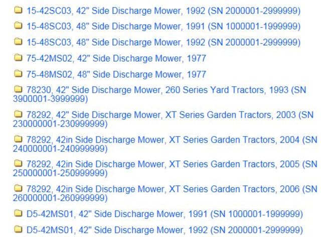

daveoman1966 3,884 #2 Posted July 10, 2015 They are Wheelhoarse blades.....here is a scipe image. Share this post Link to post Share on other sites
gwest_ca-(File Mod) 12,462 #3 Posted July 10, 2015 106077 is the individual blade that has been replaced by the 106636 3-blade set at Toro. Fits 42" side discharge decks. The reason the 48" decks show up is they share a parts list with the 42" decks in many cases.10607742in. SD (1977 75-42MS02) (1991-1992 D5-42MS01) (1991-1992 15-42SC03) (2003-2004-2005-2006 78292) {1977 1991-1992 2003-2007}106636 3-blade set42in. SD (1978 85-42MS01) (1979 95-42MS00) (1979 95-42MS01) (1980 05-42MS01) (1981-1982-1983 05-42MS02) (1982 A5-42MS02) (1984 05-42MS03) (1985 05-42MS04) (1986-1987 05-42MS05) (1988 E5-42MS01) (1982-1983 05-42SB01) (1984 05-42SB02) (1985 05-42SB03) (1985 05-42SB04) (1986 05-42SB05) (1988 05-42SK01) (1989 15-42SC01) (1990 15-42SC02) (1991 05-42SS01) (1992 05-42SS02) (1993-1994 78230) (1994-1995-1996-1997-1998-1999-2000-2001-2002-2003 78231) (1996-1997-1998-2000-2001 78232) (1993-1994-1995-1996-1997-1998-1999-2000-2001-2002-2003-2004-2005-2006-2007-2009 78345) (1993-1994-1995 78346) (1996-1997 78347) (1982 A1-114201) (1982 A1-164201) (1982 A2-113701) (1982 A2-163701) (1982 A2-164201) + 1977 {1977-2009}Garry Share this post Link to post Share on other sites
