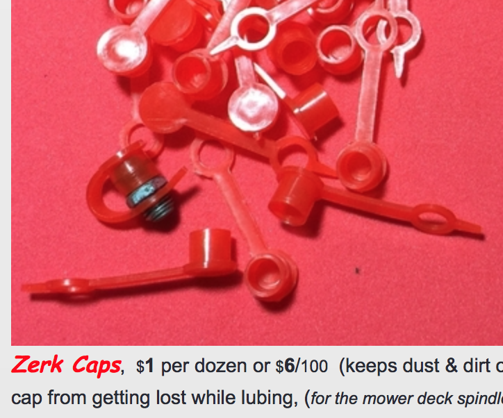

GlenPettit 1,719 #18 Posted April 25, 2017 (edited) It's a good idea to have extra protection keeping the dirt out of inside the grease fitting, these Zerk Caps fit all of our Wheel Horse fittings, (dust/sand may be pushed in when the fitting is accidently hit by dirt & bark while in use, especially the front fittings). These are very inexpensive extra protection. For the mower deck spindle fittings, cut the loop/strap off and use only the cap (small opening on belt covers). Edited April 25, 2017 by GlenPettit 2 Share this post Link to post Share on other sites
