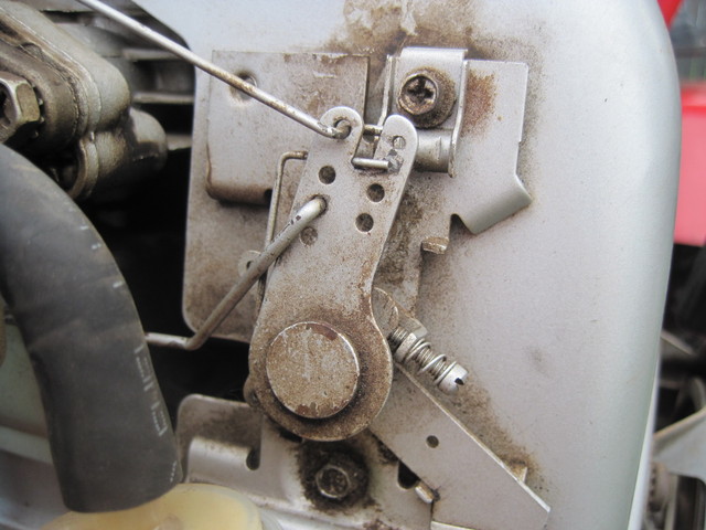

Sprocket 48 #1 Posted July 9, 2015 I know, I know - it's a Tecumseh and that's what they do...The carb shows signs of leaking at the bowl - is is a float type carb BTW. I've replaced the hose and added a filter (made for a VW Bug). I don't think the machine likes the filter. Lots of sputtering and the adjustments are very fussy. Once it was cool it would not run with out a lot of choke so I pulled the filter and let it run long enough to put back in the barn for the night.In changing out the hose I had to pull the engine cover the has the linkage - I think it's a governor or something - see the attached pics. At one point I had to remove the links from the Fritzy (that's the arm with the holes) I though I put it all back together correctly... If someone can verify this I'd appreciate it.Whereas the carb is leaking and has say for who knows how long before I got the machine I intend to get an Oregon carb and a couple parts kits for the Tecky carb. The Oregon is to prevent downtime and the multiple kits are based on my experience from days gone by when I had a Jeep that a POS carb on it. I still have my 3 lb. hammer I used to adjust the Jeep carbs...Before I start down this frustrating road, are there any cab wizards in New England willing to help/teach me the finer arts of cab adjusting and/or rebuilding live in person? I'm willing to drive to you with the machine and lunch and beverages of choice would be on me.I've pulled a lot of the manuals etc. already and started reading up on things and now that I have my engine code I can order the right parts.Thanks for looking Share this post Link to post Share on other sites

Sprocket 48 #7 Posted August 5, 2015 I'm just kinda at a loss - Could it be the points or timing related? The carb is brand new, sure it may need a tweak but if it's not firing right I'm inclined to think there's more going on than too much fuel.Of course I might be over-thinking things too, which is why I ask for your helpThanks All I'm just kinda at a loss - Could it be the points or timing related? The carb is brand new, sure it may need a tweak but if it's not firing right I'm inclined to think there's more going on than too much fuel.Of course I might be over-thinking things too, which is why I ask for your helpThanks All Share this post Link to post Share on other sites
