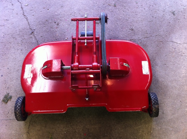

squonk 48,231 #5 Posted July 7, 2015 Here's a pic of the deck. PM me if interested 1 Share this post Link to post Share on other sites

squonk 48,231 #9 Posted July 7, 2015 (edited) RM-324 ( pictured) deck will work. This deck was on my 704. My Dad bought a 604 new in 64 with the same deck. Edited July 7, 2015 by squonk Share this post Link to post Share on other sites

stevasaurus 23,857 #11 Posted July 8, 2015 Welcome to Red Square The breakdown of the numbers of the deck like Squonk is showing. RM = Rear discharge Mower...324 = 32" deck made for the 1964 horses..the last number is the year of the deck.. Depending on the mowing you are looking to do, you may want a 36" deck. Like RM-364. Can you post some pictures from all sides of the horse. You have the mid-mount attach-a-matic for the mower deck, but do you have the quick attachment that you would need for a snow blade?? It will mount on the transmission axle. 1 Share this post Link to post Share on other sites

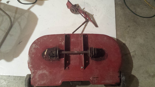

kyle 14 #12 Posted July 13, 2015 On my trip up to the cabin today I checked the basement and found the original mower deck and a snow plow attachment. Both in great condition. Only problem is the mower deck is missing a couple brackets. Now i need to search for that. I also found a second set of back tires. I'm wondering if it was a dually and how hard it is to make it one. Share this post Link to post Share on other sites

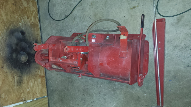

kyle 14 #15 Posted July 14, 2015 Here are a few pics of what I found in the basement. Share this post Link to post Share on other sites
octfst 378 #16 Posted July 14, 2015 That deck looks like it would work. but missing parts. but they didn't use that style till 1964. the snow blower looks like its for a vertical shaft tractor. Share this post Link to post Share on other sites
kyle 14 #17 Posted July 14, 2015 Ok so the snow blower is useless with the 753. Now i just gotta find the parts for the mower deck. Share this post Link to post Share on other sites
octfst 378 #18 Posted July 14, 2015 Ok so the snow blower is useless with the 753. Now i just gotta find the parts for the mower deck. Yes. might be easier to find a parts deck. but yes there's no way that snow blower will work with your 753. they did make them for your tractor. Share this post Link to post Share on other sites
