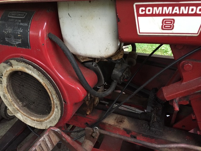

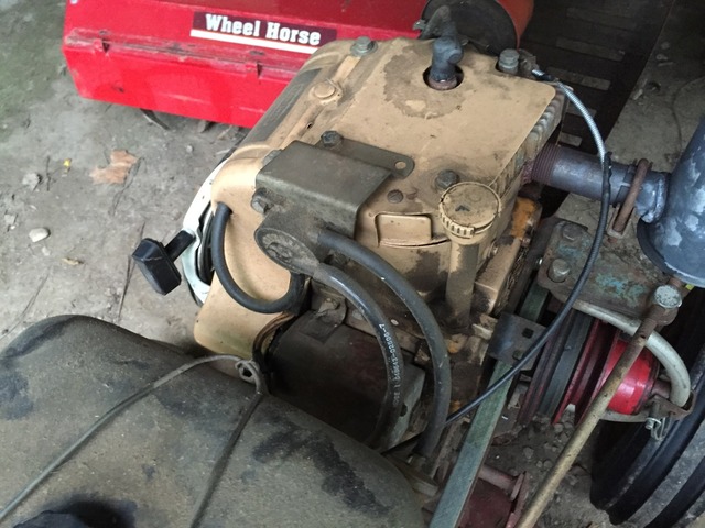

Bert 805 #3 Posted July 3, 2015 (edited) Ive used the plastic briggs fuel pumps and they work good and are cheap, the only problem is they don't mount up well and you will have to be creative. I will get a pic shortly. Edited July 3, 2015 by Bert Share this post Link to post Share on other sites
kudzu3 323 #4 Posted July 3, 2015 I tried the gravity feed, didn't work . It works well with the pump in line, but just wondering about other solutions. Share this post Link to post Share on other sites
Bert 805 #5 Posted July 4, 2015 1st pic is hard to see, its under the tank. 2nd pic is the same type of pump mounted with a bracket from a gt1100 Share this post Link to post Share on other sites
