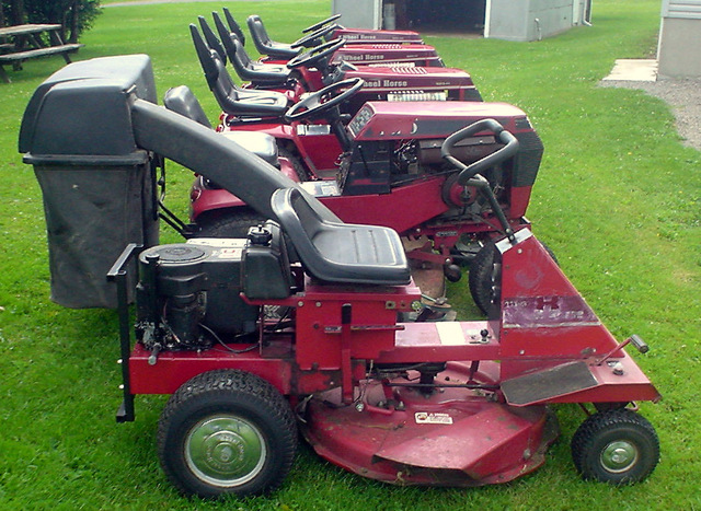

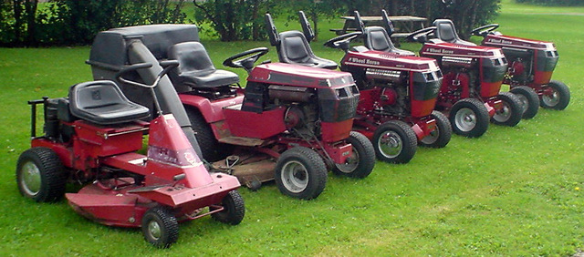

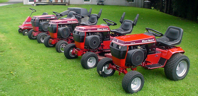

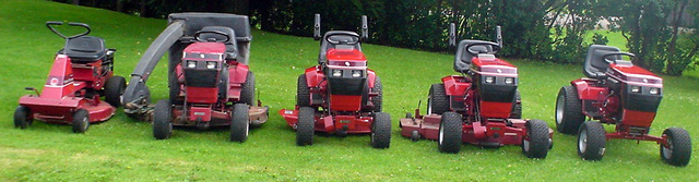

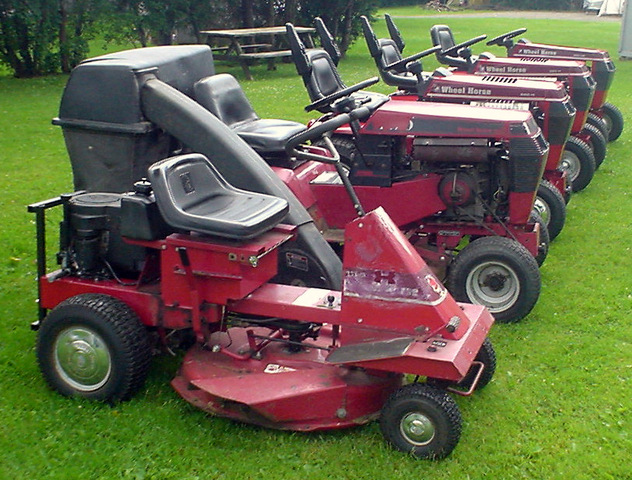

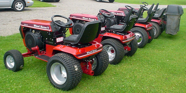

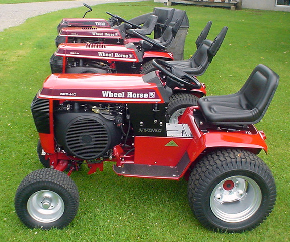

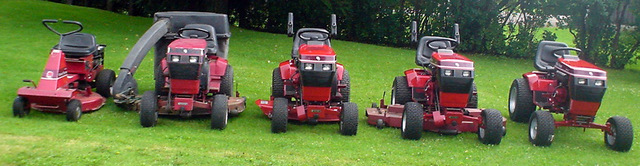

cleat 9,324 #1 Posted July 1, 2015 111-6 with 30" single blade deck416-H with 48" deck and bagger520-H with 42" deck520-H with 60" deck520-HC520-HC is still awaiting his arm rests but is otherwise complete. The 48" deck that came with it is partly restored and will be ready for next year.Thanks, Cleat 21 Share this post Link to post Share on other sites

cleat 9,324 #6 Posted July 1, 2015 All Three 520's have been completely restored.The 416 has had virtually all little bushings replaced and I just did the valve lash, changed the oil and plugs. Cleaned the Carb. Replaced battery cables. Runs great now. Just need to set idle speed as it is really low.The little 111 has had the idler pulleys replaced and main drive belt replaced. It runs great, just needs the main front decal replaced as it has been damaged by previous owners.Cleat Share this post Link to post Share on other sites

Digger 66 3,530 #12 Posted July 1, 2015 That rear engine is C O O L !!! I think I want one ...... Share this post Link to post Share on other sites
cleat 9,324 #13 Posted July 1, 2015 Looks good! How come I don't see any rain? I managed to get these horses out between rain showers.Just go them put away and a really wild lightning storm rolled through.Cleat That rear engine is C O O L !!! I think I want one ...... I picked that one up around an hour away for $150.00Could not turn it down.Just needed a battery, a belt, and an idler pulley. Share this post Link to post Share on other sites

k2wilson 41 #19 Posted July 2, 2015 What's the difference between the 520-H and the 520-HC? Share this post Link to post Share on other sites

cleat 9,324 #21 Posted July 2, 2015 What's the difference between the 520-H and the 520-HC? The HC is a commercial model with no chrome, less indicator lights, larger air filter, swept front axle and larger spindles with roller bearings, faster geared rear end.Slightly different mid Tach-a-matic, no release on the main drive belt tension.A lot of these features are present on the later model H as well.May be more but that is all I can think of right nowCleat Share this post Link to post Share on other sites
