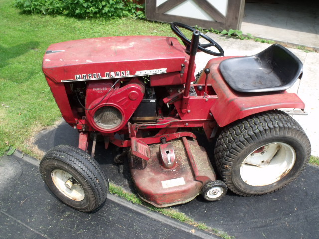

oldrigg 2 #1 Posted June 30, 2015 Have an older Wheel Horse mower and can't seem to figure out what it is. The model id under the dash is stamped "T-8", it could be the stamping isn't complete, can't find that model id anywhere. Underneath that the serial number is 377965. It has a Kohler engine with model K181S, serial number on that B274431, spec No. 30108D, It has two small bulbs for lights on the front of the hood.Does anyone know what Wheel Horse this would be and about what year it is? It looks like an older one, maybe late 60s or early 70s. Sorry I don't have any pictures on hand and don't have the machine close by but can get some next weekend if I need them. Can't figure out the idler pulley and how the belt drives the deck. Would there be a manual that would show how it should be hooked up? Share this post Link to post Share on other sites

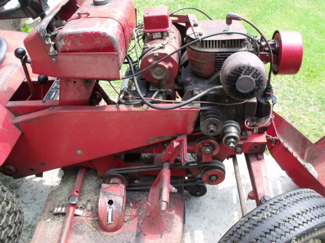

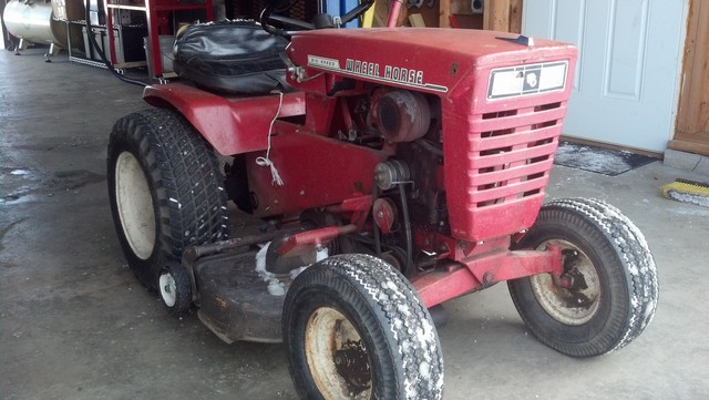

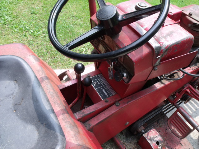

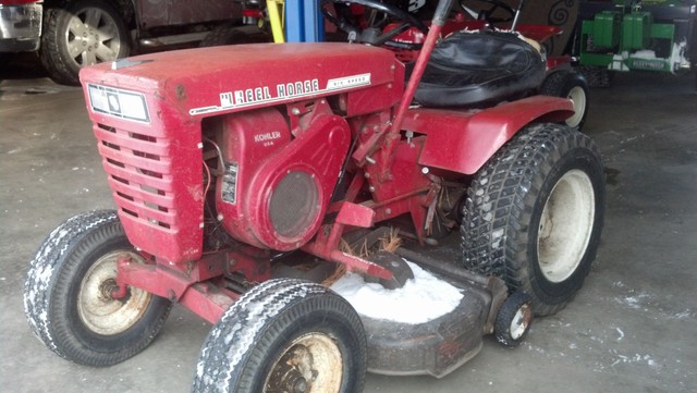

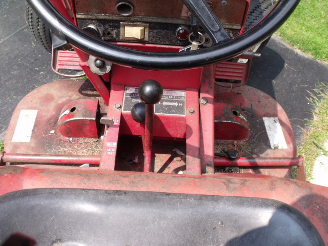

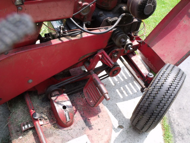

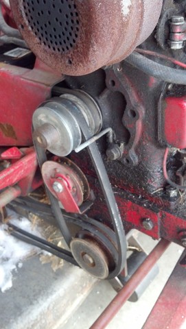

oldrigg 2 #8 Posted July 2, 2015 Some pictures of it if it helps. Do they normally come with the idler wheel by the idler pulley? Confused on how to hook up the belt to drive the deck. 1 Share this post Link to post Share on other sites
CasualObserver 3,417 #9 Posted July 2, 2015 Yep... low and behold... an 867. 8 Hp 6 speed trans 1967 model year. Oh, and there will be another belt to hook up the deck that goes around the three pulleys... I'll see if I can find you a pic Share this post Link to post Share on other sites
rmaynard 17,644 #10 Posted July 2, 2015 Looks like an 867 to me. Share this post Link to post Share on other sites
CasualObserver 3,417 #11 Posted July 2, 2015 This post shows what the pto to deck belt would look like. Share this post Link to post Share on other sites

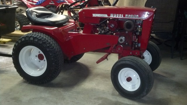

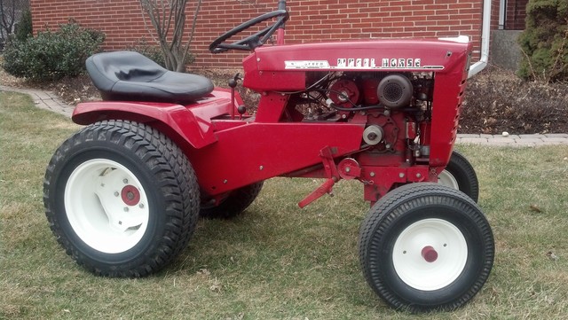

RedRanger 1,470 #12 Posted July 3, 2015 (edited) Some pictures of it if it helps. Do they normally come with the idler wheel by the idler pulley? Confused on how to hook up the belt to drive the deck. Odd pulley set up. Maybe for some other attachment??Looks like it has had other attachments bolted to the front of the frame.My 867 for your view.Day I bought it. Mower drive system.The red idler pulley retainer strap should have been on the outside of the belt. Edited July 3, 2015 by RedRanger 1 Share this post Link to post Share on other sites

oldrigg 2 #16 Posted July 6, 2015 (edited) Sorry, I couldn't get back earlier to thank you for all the information. I can't seem to post from my computer at home so had to wait until work today. RedRanger thank you for the photos. Very nice looking tractor you have there. That picture helps a lot. I'm not sure why my machine has that extra idler wheel or what it does but I tried to hook up a belt around it and it goes around but the that idler wheel gets really hot... the inside sleeve was starting to turn blue from getting so hot and then the belt came off. I think I can take that idler wheel off. Ours is missing that extra guide that bolts in front of the top pulley and I think thats where the idler wheel was fastened spinning on the bolt. Have to try to figure out how to lower the blades next. Thank you again. Edited July 6, 2015 by oldrigg 1 Share this post Link to post Share on other sites
