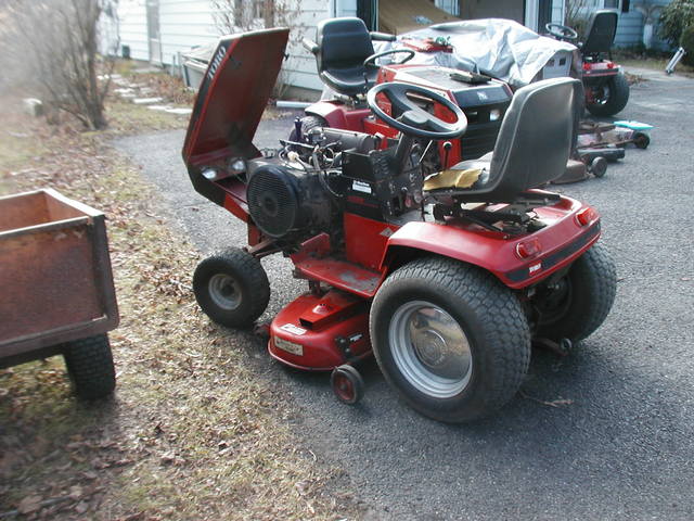

JackC 619 #11 Posted July 1, 2015 (edited) My 1990 416H came with 6 inch front shoes: Edited July 1, 2015 by JackC 1 Share this post Link to post Share on other sites
