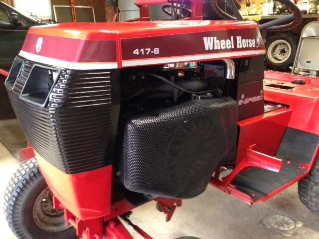

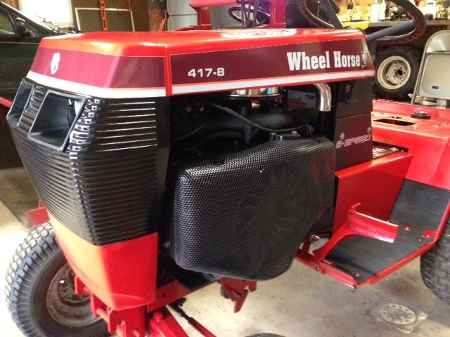

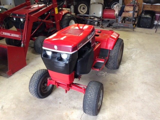

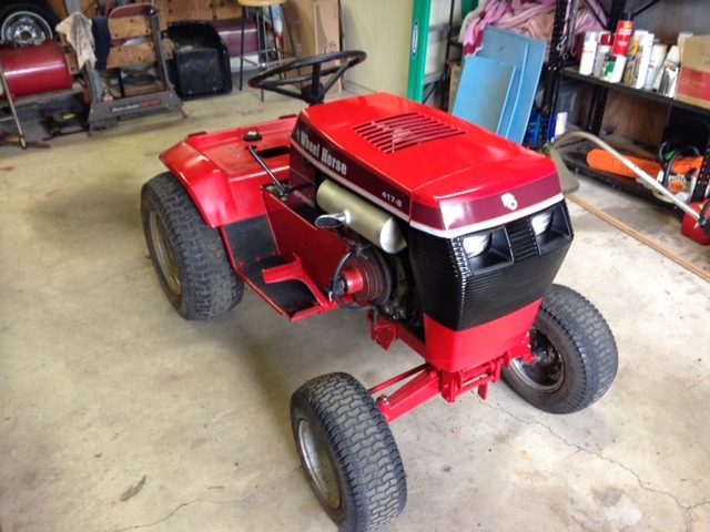

boovuc 1,090 #1 Posted June 29, 2015 Gentlemen,I have been working since late April on a refresh of a 417-8 I picked up. 1280 hours and it was in pretty good mechanical shape but was getting pretty rusty. (It wasn't left outside it's whole life but it was outside some).The idiot lights worked except for the Parking Brake Light but.after putting this back together, all I have is the oil pressure light that works off the test switch and before starting. Nothing from the others.Observations: When I hit the test switch with the key off, the oil pressure light comes on and I also get 12.5 volts through the volt gauge. Again, this is with the key off.My 416-8 Onan won't even test without the switch on but then again, that thing was haywired when I got it and I have no other tractor with the idiot lights to compare to.Ground is good or I wouldn't get the oil pressure light. I handled that circuit board like a mercury switch hooked to a bomb so I don't think I knocked anything loose.I cleaned all the connectors before re-installing. The parking light didn't work because the little seed lamp is missing.While you are pondering that, I noticed the headlights are 50 watt halogens. My others are 35 watt non-halogen.Are we cool with the 15 more watts on the headlight circuit? Oh and what is the replacement bulb for the tail lights. (Push in bulb reminds me of the old flash bulbs of the 60's). I have one out and nothing to steal from!It's turning out decent. I still need to change out tires, paint the rims and hubs and get my seat back from a local upholstery shop. Thanks! 2 Share this post Link to post Share on other sites
AMC RULES 37,259 #2 Posted June 29, 2015 Is looking really good Boo. Share this post Link to post Share on other sites
