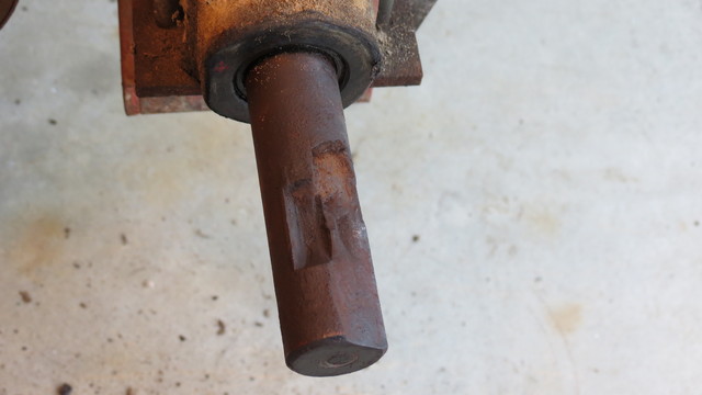

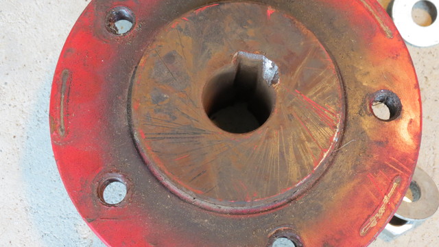

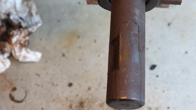

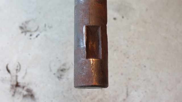

Ok...raining outside here in Akron so I decided to re-engage repair diagnosis of the 310-8 after hearing from the above posters and thumbing through the tranny section of the forums. I checked and could not find a idler pulley stop so I removed that solution from my review (and believe me when I say I had hoped this fix was the solution). I saw that in one of the forum topics was a mention of the rear wheel set screws and the woodruff key. Jacked the rear end up and pulled the wheels to find that on the left side axle, the end of the axle had split at the edge of the keyway. The right side found that the woodruff key had fallen out at some time. Apparently, both rear wheels were "free rolling" when a load was put on the tractor and the wheels/hubs were not tightly attached to the axles.
I'm hoping that I can weld the piece back onto the axle and grind it down so the left hub can fit. On the right side, because the hub is cobbed up inside the keyway, I'm probably going to have to replace the hub itself.

Ed Kennell
http://www.wheelhorseforum.com/topic/56859-key-way-fix/
Here is the link to an axle repair that I made.  Yours is much worse though, and I would recommend replacing the axles and hubs.
If the hubs only have one set screw on the keyway, I would add the second one @‌ 90 degrees , and use hardened square head bolts with locknuts, not socket head set screws. Edited by ekennell
