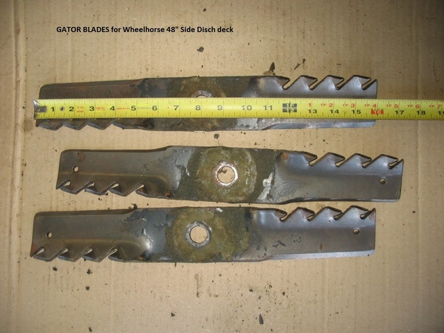

daveoman1966 3,884 #2 Posted June 25, 2015 Am I allowed to tell you I have a set of 48" Gator Blades listed on E-bay? # 131494531912 Share this post Link to post Share on other sites
