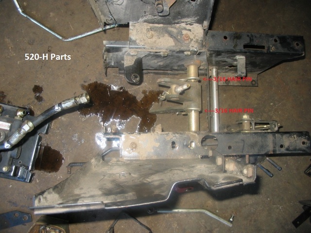

daveoman1966 3,884 #6 Posted June 23, 2015 I have use a pneumatic HAMMER on these...lost of penetrant.... usually comes apart, but very reluctantly. 1 Share this post Link to post Share on other sites

cod 136 #8 Posted June 23, 2015 Thanks guys. I suspect instead of thinking it might come off on the tractor, I should have done as Dave shows in his picture and then gone with Cleat's suggestion although I'm not sure if I can find a 20 ton press.Another "simple weekend" project that goes on forever... Share this post Link to post Share on other sites
