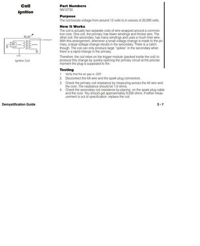

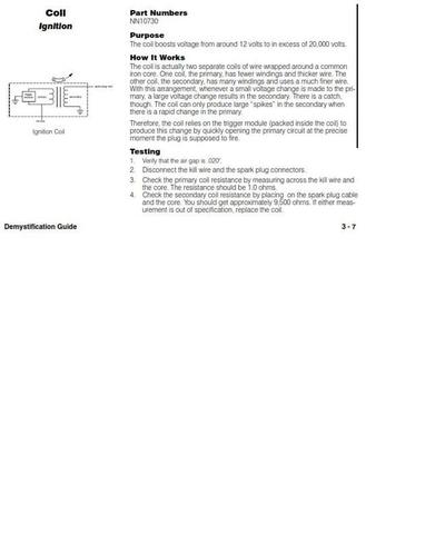

Alex from GA 3 #6 Posted June 22, 2015 I found the coil open and looked for a replacement and it's almost $200 for an NN10730 coil. I was floored. I'm retired on a fixed income. Does anyone know of a different part no. that fits? Thanks. Another person asked the same question in 2012 and didn't get an answer. Share this post Link to post Share on other sites

gwest_ca-(File Mod) 10,539 #8 Posted June 22, 2015 You saw this?I see RCPW wants $170 but then you have to add shipping. Very popular engine I think so a used coil should be available.Garry Share this post Link to post Share on other sites
