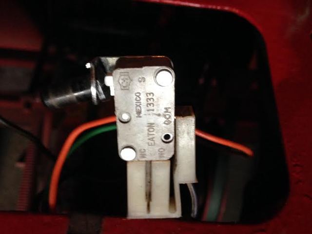

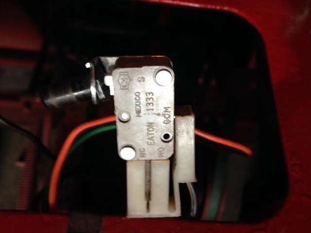

Maytag 0 #1 Posted June 21, 2015 (edited) seatSwitch (1) seatSwitch (1) The safety switch on my 1989 ( I believe) has broken. The switch is labeled "Eaton 1333 Mexico", which leads me to believe it is not original. Where can I obtain a replacement switch? Thanks to all.I have attached a picture of the current switch which has three wires, not 2. Is one not needed?T Edited June 21, 2015 by Maytag added picture Share this post Link to post Share on other sites

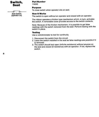

gwest_ca-(File Mod) 12,489 #3 Posted June 21, 2015 (edited) Found this for the 114240 switchAdding - As soon as I posted this it looked wrong. Here is the detailed wiring diagram that shows just the opposite test results which I think are correct.http://www.wheelhorseforum.com/files/file/5014-tractor-1989-414-8-wiringpdf/Perhaps in this application a different pair of terminals are used as usually one pair will be normally open when the other pair are normally closed when there are 3 terminals. One is common to the other two.Garry Edited June 21, 2015 by gwest_ca Share this post Link to post Share on other sites
