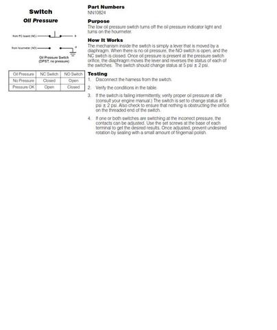

Is there a way to test the oil sending unit? Just took it out.
gwest_ca
From the Demystification Guide
Garry

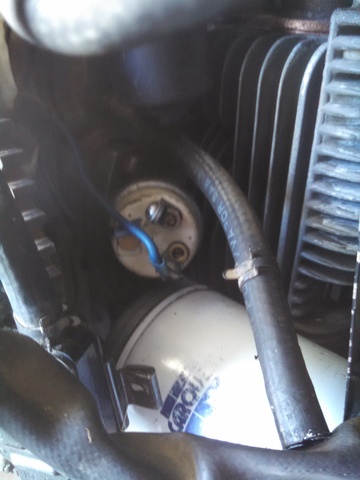

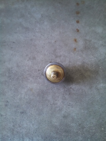

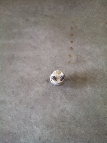

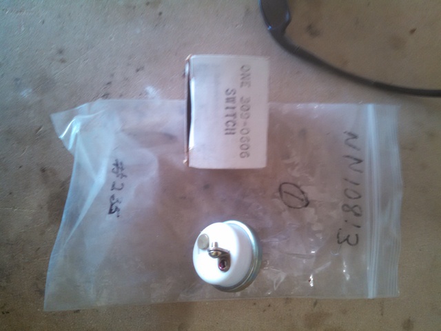

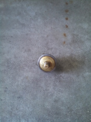

This is the new oil sending unit I got. It does not have 2 brackets for the wires to attach to. Suggestions?? The other picture is what is on the onan now.

WNYPCRepair
Are there two wires that connect to the old one? I only see one
gwest_ca
Different part number also. I recall many switches listed in an Onan parts list depending on what you wanted it to do. Did you order the NN10824?

WNYPCRepair
Garry
Bag says NN10813
608KEB
I think the box has the right parts number. The bag is the wrong parts number along with the switch. I've been waiting over 7 weeks to get this part. Would somebody  have any ideas where else to try to source this switch?

608KEB
Would somebody know of another oil sending unit that would work? A different parts #?
608KEB
I got this today 309-606. Will this work it does not have a ground connector for the hour meter. Will it operate the oil light correctly. Will it open and close at 5 psi + or - 2 psi? I don't know what the numbers mean on the side of the switch. I can ground my hour meter to the engine. I hooked it up and the oil senor light did nothing. I'm starting to think I have a bad connection somewhere.
