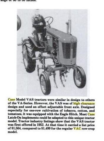

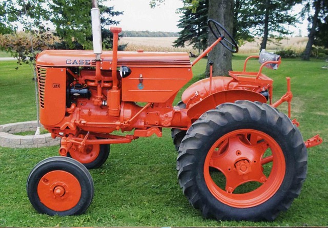

pfrederi 20,627 #7 Posted June 17, 2015 Prior to the wide spread use of chemical weed control cultivating was a big part of farming. Tractors were specially designed with high clearance to avoid damaging the crops while getting rid of weeds. Cultivating is actually making a comeback amongst the organic grower crowds and some of the 50-60 year old tractors and their cultivators are getting back into use. 3 Share this post Link to post Share on other sites
Rob R 989 #8 Posted June 17, 2015 Prefredi is right on. We still have at least 3 old Internationals and a diesel Ford which are dedicated to cultivation this along with 2 three point hitch (Knife) cultivators on which a person sits and controls the left and right movement of the two row cultivators as the tractor pulls it along the row. With this device you can do the neatest and cleanest job. Share this post Link to post Share on other sites
