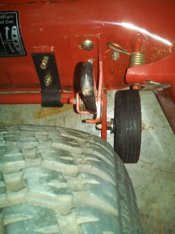

daveoman1966 3,884 #3 Posted June 14, 2015 The guage wheels of the deck bang into the rear wheels / tires of the tractor, cause the tires are 10.5 or wider. I'd thin you could 1) mount smaller 8.5 or 9.5 tires/wheels onto the 520HC or.... 2) take the gauge wheels AND AXLE off of the 42" deck and replace it with a gauge wheel axle setup from a 48" wide deck. The gauge wheels on the 48" deck are set wider than on a 42" deck and should clear the rear tires of the tractor. You MAY have to mod the gauge wheel axle clamps on the deck to accommodate a wider axle, but it seems to me that this would work.Just a thought or two. 1 Share this post Link to post Share on other sites
stevebo-(Moderator) 8,741 #4 Posted June 14, 2015 I have an 88' 520HC and have been using a 42" RD deck with no issues. The side discharge can be used but the rear wheels will hit the deck rear wheels every once in a while making hard turns. Share this post Link to post Share on other sites
Mike's 520HC 5 #5 Posted June 14, 2015 Thanks guys. It might be better to just change out the rear wheels. I'll modify the left rear deck wheel for a temp. fix then either locate rear wheel assemblies or step up to a 48. Share this post Link to post Share on other sites

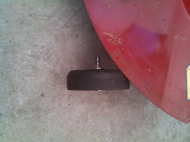

608KEB 829 #6 Posted June 16, 2015 Move the gauge wheels forward about 2". Drill new holes for gauge wheels. That's what I did. It's works great. 1 Share this post Link to post Share on other sites

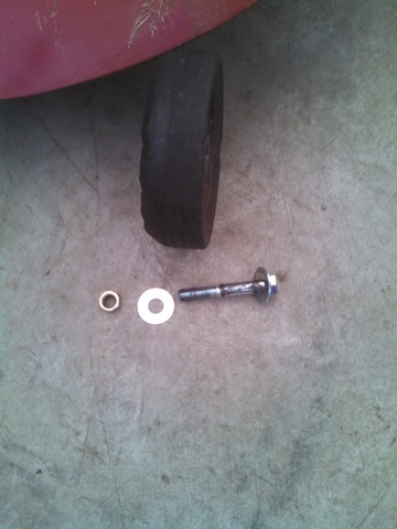

608KEB 829 #7 Posted June 21, 2015 The wheel is still rubbing against the tire. Just a little bit. I picked up a longer gauge wheel bolt. I'll post some pictures soon Share this post Link to post Share on other sites
608KEB 829 #8 Posted June 21, 2015 I haven't tried it yet. It should work fine. Share this post Link to post Share on other sites
