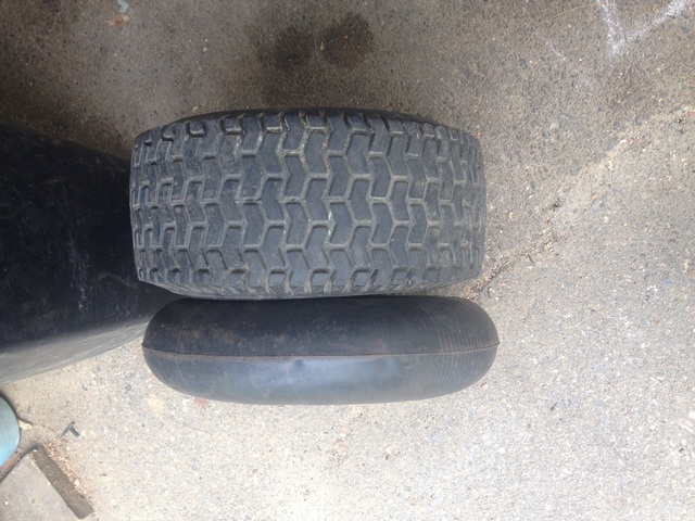

jake22si 5 #1 Posted June 14, 2015 I got sick of having to fill a tire with air whenever i wanted to take my c125 for a spin. I bought a tube at lowes, its a tireaid brand 16x6.50x8, straight stem. First it didn't seem like the stem would last long being at an extreme angle like that, and when I had it all together, pumped up the tube, it was extremely skinny and did not come close to the side walls. I took it out again and put it around the rim and blew it up. The diameter and height seems good but the width really isn't there, almost half the rim width. The tube says the correct size right on it so it wasn't in the wrong box. I compared it to a similar atv tube and confirmed it seemed much skinnier. Any one else have this problem? Share this post Link to post Share on other sites

jake22si 5 #3 Posted June 14, 2015 I'm afraid the valve stem will get sheared off. Its blown up all the way and won't set the sidewalls? Share this post Link to post Share on other sites
Racinbob 13,275 #5 Posted June 14, 2015 You need to inflate them until the bead pops on the rim then adjust the pressure. You'll be fine. Don't fret over the tube size in the picture. It will fill out the tire nicely. 2 Share this post Link to post Share on other sites

jake22si 5 #7 Posted June 15, 2015 Seems if I inflate it any more it would pop, in the pic it is inflated quite a bit. Share this post Link to post Share on other sites
Racinbob 13,275 #8 Posted June 15, 2015 You don't want to get too much pressure in it without being in a tire. Just go ahead and install it. Make sure there's nothing inside the tire that could puncture it and that it won't get pinched in the bead. Pump her up until the bead seats and then adjust the pressure. It may take 30-40 psi to seat it. It's just the way it's done and it won't blow. 1 Share this post Link to post Share on other sites
