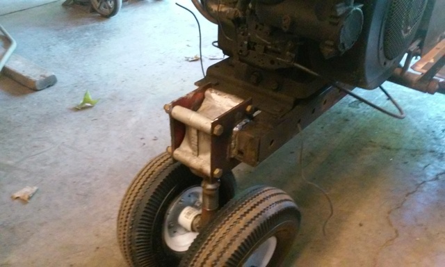

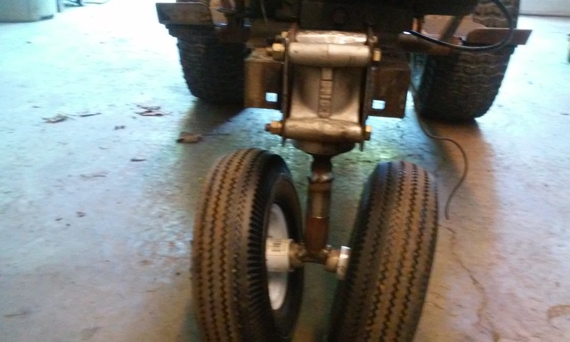

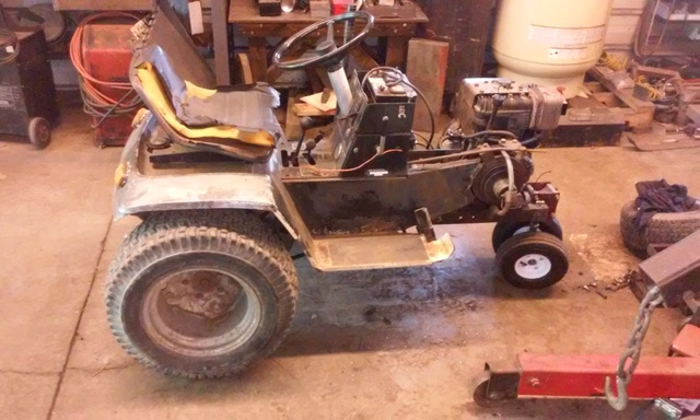

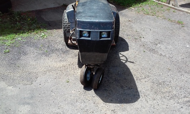

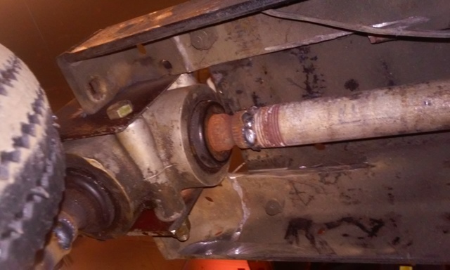

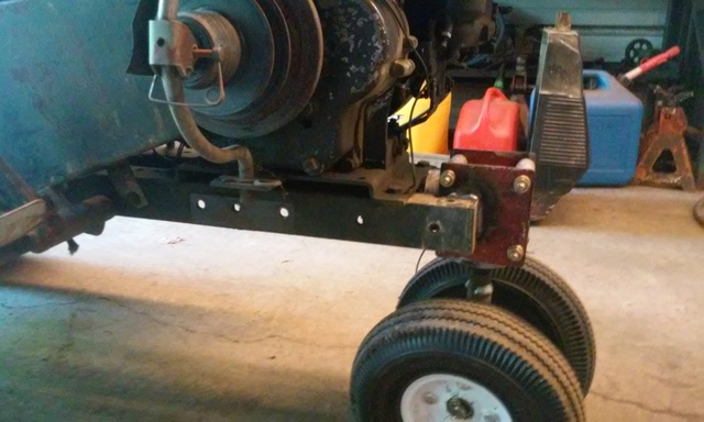

steve k 82 #1 Posted June 13, 2015 Here are some pictures of a GT 1100 I am making narrow. The tractor isn't pretty but it runs well so I figured it as a good candidate. I still have to get the hood back on and clean up everything then paint it but here are some pictures. I used a 90* steering gearbox from a bus. 6 Share this post Link to post Share on other sites
953 nut 70,078 #2 Posted June 13, 2015 I like it! Hope the gear box holds up, not sure what type bearings are in it, the thrust placed on it from the weight of the front of the tractor could shorten the life expectancy, but if you are just driving it at the occasional show it may do alright. Share this post Link to post Share on other sites
steve k 82 #3 Posted June 14, 2015 Thought about that 953. It is designed for the shaft between the steering wheel and the steering box on a bus so I imagine it is pretty robust regardless how it is used. We had to change out a bunch of them one time......they were built with the wrong grease in them and when it got below zero you could not hardly turn the wheel. The weight on it is less than 100 pounds as that briggs is much lighter than a kohler. 2 Share this post Link to post Share on other sites

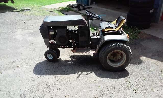

steve k 82 #4 Posted June 14, 2015 Got the hood back on. Now to make it look respectable. 2 Share this post Link to post Share on other sites

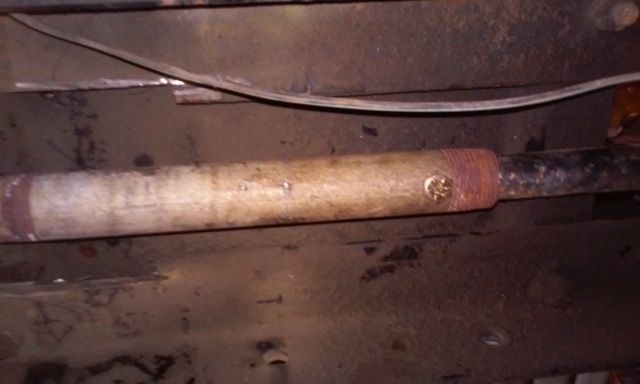

GT14 243 #5 Posted June 16, 2015 Nice idea. Are there stops on the rotation. Share this post Link to post Share on other sites
steve k 82 #6 Posted June 16, 2015 yes GT, Since I still have the original steering shaft and fan gear the stops are right where they were. Share this post Link to post Share on other sites

sharkman 4 #12 Posted June 18, 2015 nice Job! Just wondering if you have tried 6" wheels for the front? I want to buildi narrow front end and have looked at a lot of pictures of them. I think (IMHO) the 6" (rim size) just look to be a better ratio than the 4". Share this post Link to post Share on other sites
steve k 82 #13 Posted June 25, 2015 Shark, all the 6 inch wheels I have are pretty wide and require new tires. I used these because I got them for 6-7 bucks each at HF. Rob, I will try to get a vid put up sometime. Share this post Link to post Share on other sites

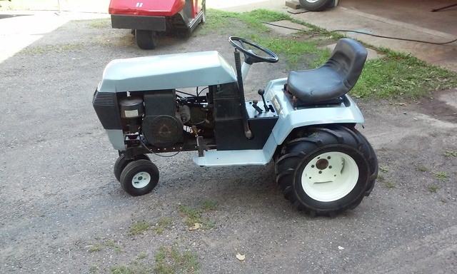

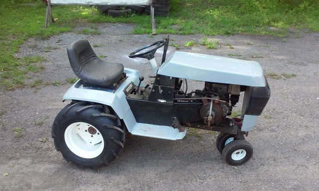

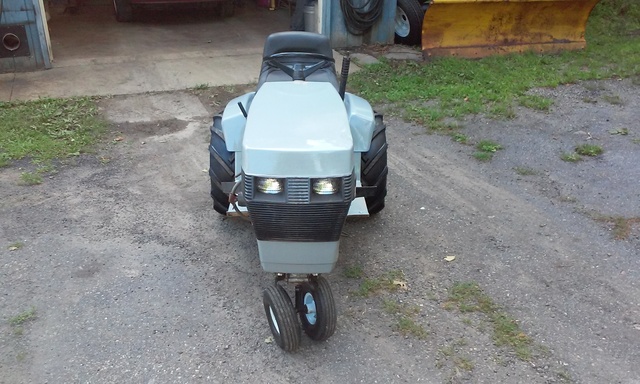

steve k 82 #14 Posted July 23, 2015 Got some paint on the tractor lately, it is far from perfect but looks better. Also new rear tires. I think it will be my tractor for pulling the roller, trailer, old engines on carts, etc.... 3 Share this post Link to post Share on other sites
