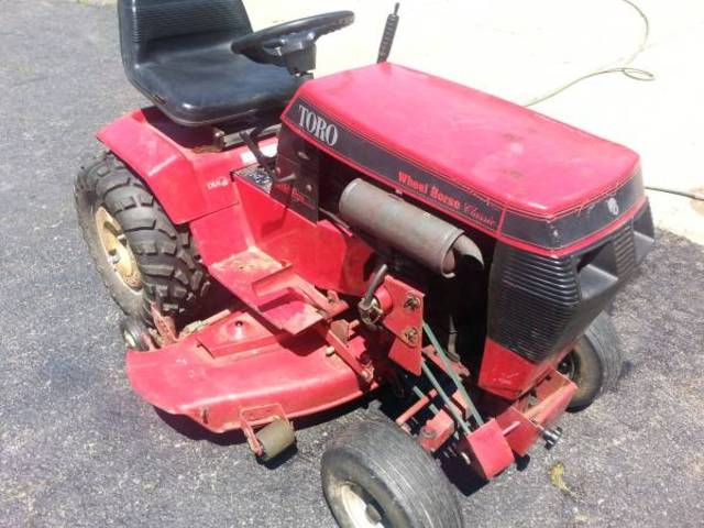

WNYPCRepair 1,924 #1 Posted June 12, 2015 A guy locally is selling a Classic with a 42" 2 stage thrower. Does anyone know if it will fit a 95 520-H? I don't have any other info on the Classic, guy doesn't list year or model at all, I just see Classic on the hood Sorry if this is a newbie question, but I have to learn somewhere, right? Share this post Link to post Share on other sites

WNYPCRepair 1,924 #3 Posted June 12, 2015 I have that, but have no idea what year or model the Classic is. Share this post Link to post Share on other sites

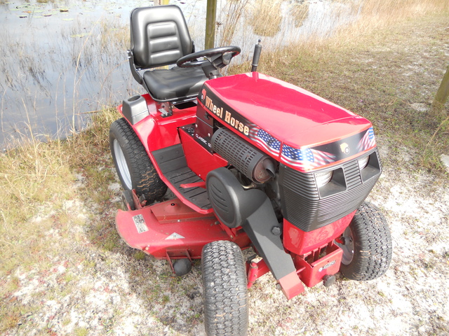

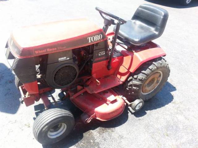

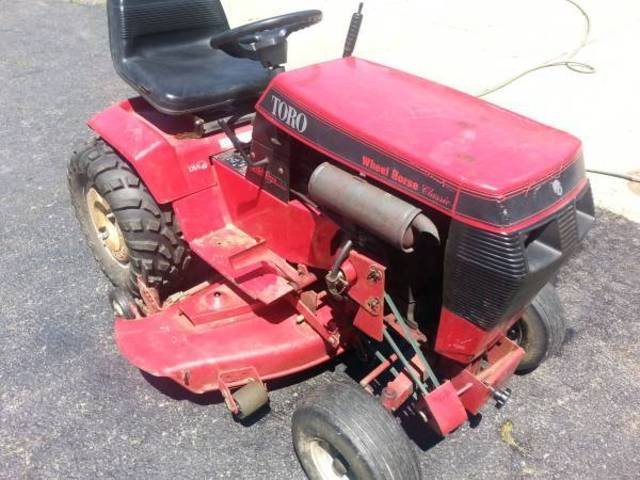

Racinbob 12,988 #7 Posted June 13, 2015 By any chance can you copy and paste a picture of it? When you say Classic I'm thinking it's like my 2005 which has Classic on the side. If that's the case the blower will work fine. The Classic is what Toro started calling them and they are identical to the 3-400 series. A picture would confirm it. Share this post Link to post Share on other sites
Racinbob 12,988 #8 Posted June 13, 2015 I'll just do this. Does it look like this 'Classic'? If so, you're good to go. Share this post Link to post Share on other sites
WNYPCRepair 1,924 #9 Posted June 13, 2015 A little older than yours, I think. Share this post Link to post Share on other sites
Racinbob 12,988 #10 Posted June 13, 2015 Yup, that one is a bit older but you're good to go. That blower will hook right up. One thing though. I've only used single stage blowers. Is that a 10 horse I'm seeing? You might wish you had more power to turn a 2 stage. Share this post Link to post Share on other sites

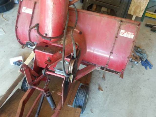

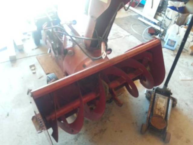

MalMac 1,336 #11 Posted June 13, 2015 (edited) If it's really a 42 in. It is probably a single stage blower. If that is the case the blower will need the lift tube to be the one with a slight bend in it to work on a 520h with swept axel. Now if it is a 2 stage it will fit a 520 just fine because the 2 stage was really designed for use on the 520. Something else just came to mind. Is the blower a Wheel Horse blower? If not then all advise just given is null and void. Because I have no experience with any other blowers and there for do not know what I am talking about. Am I reading the post wrong Racinbob, I took it he wanted to know if the blower off the classic would fit a 520? Edited June 13, 2015 by MalMac Share this post Link to post Share on other sites
WNYPCRepair 1,924 #12 Posted June 13, 2015 I agree, that's why I want to see if it will work on a 520. I've been looking at a 520, and this blower will fit it, so I am hoping to grab both Share this post Link to post Share on other sites
WNYPCRepair 1,924 #13 Posted June 13, 2015 If it's really a 42 in. It is probably a single stage blower. If that is the case the blower will need the lift tube to be the one with a slight bend in it to work on a 520h with swept axel. Now if it is a 2 stage it will fit a 520 just fine because the 2 stage was really designed for use on the 520. Something else just came to mind. Is the blower a Wheel Horse blower? If not then all advise just given is null and void. Because I have no experience with any other blowers and there for do not know what I am talking about. You guys would definitely know better than me. What do you think? Share this post Link to post Share on other sites
baerpath 517 #14 Posted June 13, 2015 Yup Wheel Horse two stage Will direct fit any from 1973 through the 500 series as long as it has quick attach Share this post Link to post Share on other sites
MalMac 1,336 #15 Posted June 13, 2015 That is a 2 stage, will hook right up to a 520. Share this post Link to post Share on other sites
Racinbob 12,988 #16 Posted June 13, 2015 If it's really a 42 in. It is probably a single stage blower. If that is the case the blower will need the lift tube to be the one with a slight bend in it to work on a 520h with swept axel. Now if it is a 2 stage it will fit a 520 just fine because the 2 stage was really designed for use on the 520. Something else just came to mind. Is the blower a Wheel Horse blower? If not then all advise just given is null and void. Because I have no experience with any other blowers and there for do not know what I am talking about. Am I reading the post wrong Racinbob, I took it he wanted to know if the blower off the classic would fit a 520? You're reading it right. It's me who got things backwards. Share this post Link to post Share on other sites
