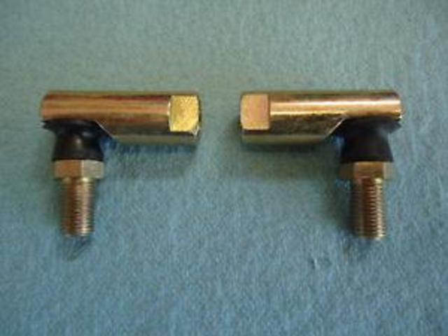

Racinbob 13,122 #2 Posted June 8, 2015 I've used these quite a few times. Less than $10 a pair. 1 Share this post Link to post Share on other sites

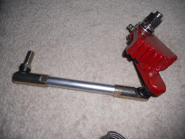

Don1977 606 #3 Posted June 8, 2015 I did this 26 years ago. Still works great. 4 Share this post Link to post Share on other sites
Fordiesel69 272 #4 Posted June 8, 2015 I've used these quite a few times. Less than $10 a pair. Where did you buy these? Share this post Link to post Share on other sites

RedRanger 1,470 #7 Posted June 8, 2015 I've used these quite a few times. Less than $10 a pair. What do you use between them? Share this post Link to post Share on other sites
Racinbob 13,122 #8 Posted June 8, 2015 For a Suburban drag link I used 3/8"-24 threaded rod with a piece of 1/2" OD steel tube the correct length over it. There's no need for adjustment in this application. For an adjustable tie rod you'd want to use a jam nut. Share this post Link to post Share on other sites
Racinbob 13,122 #9 Posted June 8, 2015 I've used these quite a few times. Less than $10 a pair. Where did you buy these? I got those at Ace Hardware. There's a gazillion of them on Ebay cheaper but I was in a hurry. Tractor Supply also has them as well as many other places. Share this post Link to post Share on other sites
squonk 48,038 #10 Posted June 8, 2015 I did what don did on my 704 Share this post Link to post Share on other sites

KC9KAS 4,746 #12 Posted June 9, 2015 I've used these quite a few times. Less than $10 a pair. Where did you buy these? I got those at Ace Hardware. There's a gazillion of them on Ebay cheaper but I was in a hurry. Tractor Supply also has them as well as many other places. You can see these on the web...McMaster Carr...many different types....Left and right hand threaded if you need them that way. Share this post Link to post Share on other sites
