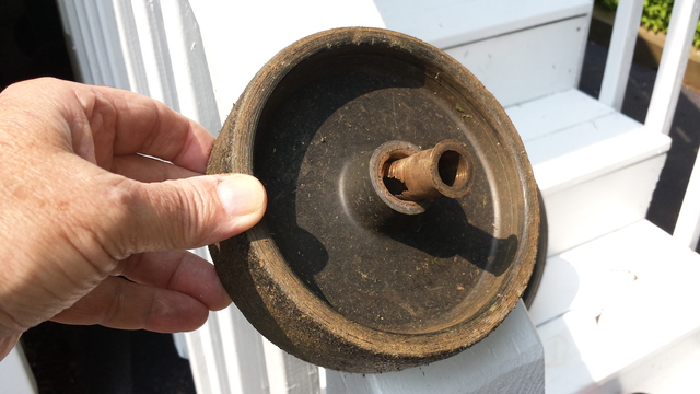

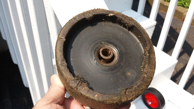

JERSEYHAWG / Glenn 4,590 #1 Posted June 8, 2015 (edited) Ok, who uses what kind of a mower rear deck wheel of thier xi mower deck? After doing the lawn today I noticed mine are pretty beat. I have the mower deck book, but it doesnt give the wheel part number. And I was asking if any of you had a beefier replacement that works. I will want to replace the wheel bolts also. The PO put a good beating on the old ones, so its time for replacement. Thanks guys.edit: fellas I made a mistake, its the rear wheels that need replacing, Don pointed out my flub to me. Apologies,,,,,,Glenn Edited June 9, 2015 by JERSEYHAWG / Glenn Share this post Link to post Share on other sites

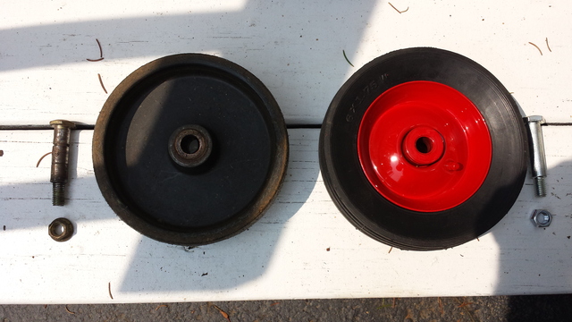

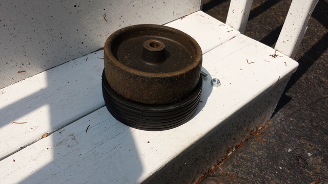

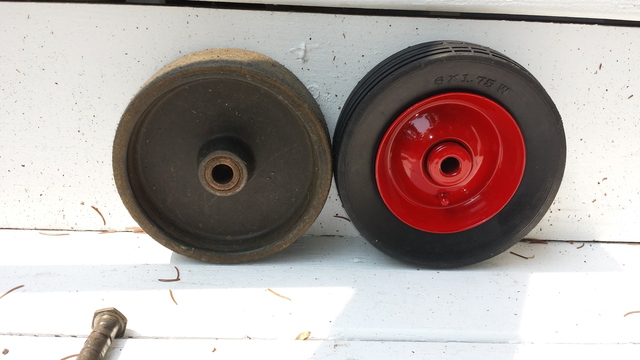

JERSEYHAWG / Glenn 4,590 #5 Posted July 5, 2015 Ok, now for what I decided to do on the deck wheels. For starters I took a wheel off my 520 48 inch deck. It mounted right on the 5xi deck. A couple of test mows on the lawn and no problems encountered. So, I decided to order a set of NOS old style deck wheels for the 5xi deck. Why? Because the factory 5xi deck wheels are cheap and cheesy plastic, with a brass ferrel that like a rolled up dollar bill, Imho, garbage. The old style wheels are HEAVY rubber and a HEAVY metal rim with a grease zerk to. They are a tad taller. Anyway thats what I did to resolve me 5xi deck wheel replacement. Oh, the old style wheels besides being built better are cheaper to.Glenn Share this post Link to post Share on other sites
RMCIII 840 #6 Posted July 13, 2015 Interesting! The replacements have zerts.RMC Share this post Link to post Share on other sites
