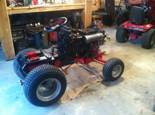

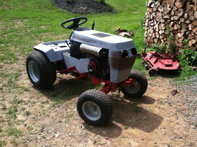

stevebo-(Moderator) 8,742 #54 Posted June 15, 2015 This afternoon I changed the engine wiring harness and also a few other electrical upgrades... Thanks to Jeff for helping make sense of the wiring diagram. She is a runner and a strong runner. I had to swap over the drive pulley on the engine with the smaller 8 speed pulley. It has the typical Onan surge. Pulled carb top off and it was a little dirty. Need to fix that but she runs and drives and the motor seems very strong. 2 Share this post Link to post Share on other sites
squonk 48,037 #55 Posted June 15, 2015 Throw a seat and some lights on it and call it good. Looks like a Hot Rod! Share this post Link to post Share on other sites
AMC RULES 37,259 #56 Posted June 16, 2015 Does look good just sittin' in the barn. Share this post Link to post Share on other sites
stevebo-(Moderator) 8,742 #57 Posted June 16, 2015 I am pretty sure this motor was worked on a one time. It sounds really strong and you can tell the exhaust is crisp. Share this post Link to post Share on other sites

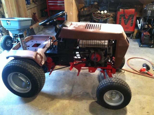

stevebo-(Moderator) 8,742 #61 Posted June 16, 2015 Did a "proper" cleaning of the carb and blew out all the passages and it now runs correct with no surging. Tins got dropped at sandblaster today. It things go right I will be painting them this weekend !! Share this post Link to post Share on other sites

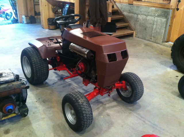

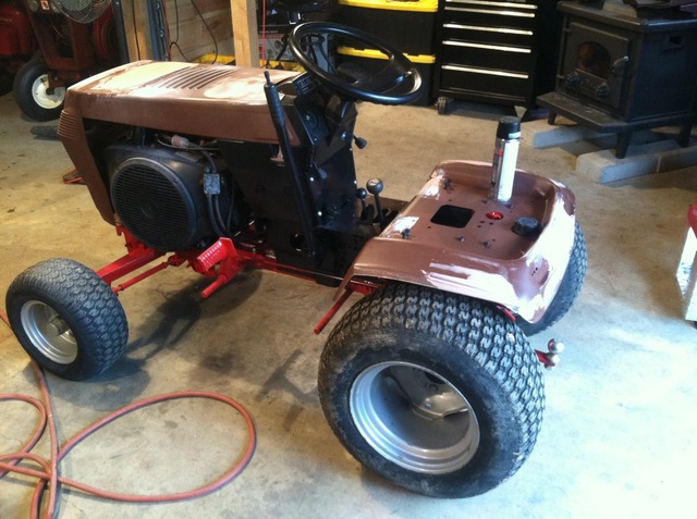

stevebo-(Moderator) 8,742 #62 Posted June 18, 2015 My sandblaster got these tins turned around in less than 1 day. Picked them up after work today and got them in primer. There is a bit of bodywork required before I paint. I just ordered more valspar hardener. By the end of the weekend I hope to have it ready for paint. 3 Share this post Link to post Share on other sites
JERSEYHAWG / Glenn 4,589 #63 Posted June 18, 2015 Steve, nice job. Turning it into a sweetheart. Cant wait to see you paint it.Glenn Share this post Link to post Share on other sites
stevebo-(Moderator) 8,742 #65 Posted June 19, 2015 Got some filler on it this afternoon. Share this post Link to post Share on other sites

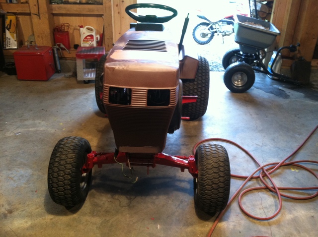

stevebo-(Moderator) 8,742 #71 Posted June 20, 2015 Ready for wet sanding and a final priming/filling prior to paint. Share this post Link to post Share on other sites
