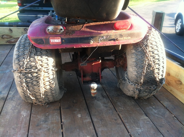

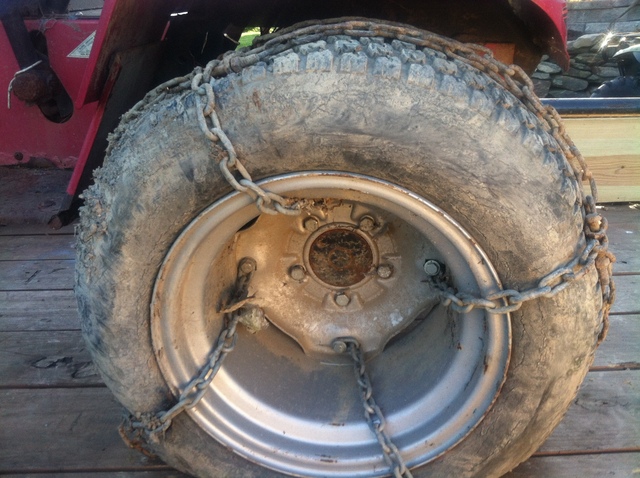

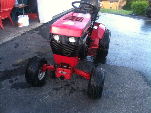

stevebo-(Moderator) 8,625 #5 Posted June 8, 2015 I did. I got a call from my good friend Fireman this afternoon and he told me about the two. I was on the road so I had him contact seller and set up the pick up. Fireman was at work until tomorrow so he could not make the trip. The owner was nice but man he was out there in the sticks... Anyhow here are the before and after cleaning pics. This guy literally made his own tire chains. Check this out... 6 Share this post Link to post Share on other sites
stratostar250 934 #6 Posted June 8, 2015 At first glance, those tire chains, gave me the feeling, but with the tires inflated, they look pretty decent! Nice grab. Looks like you got another rare one! Share this post Link to post Share on other sites

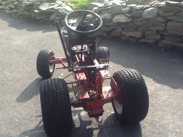

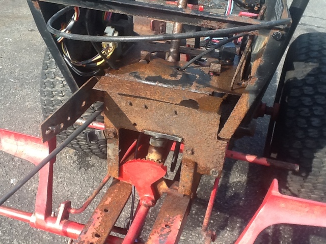

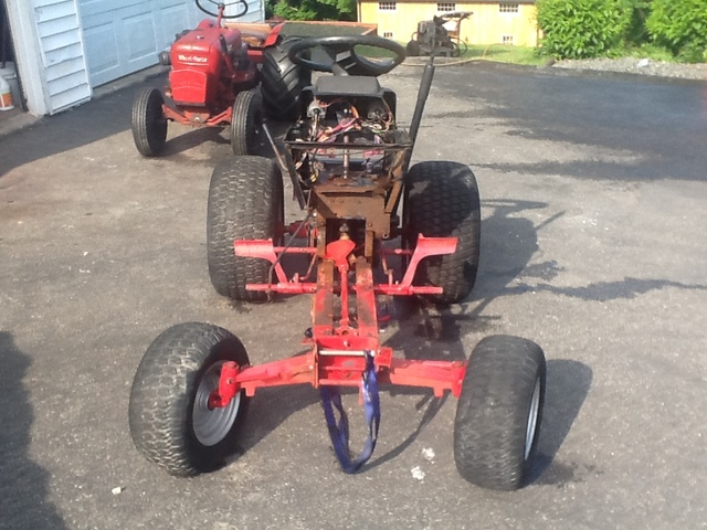

stevebo-(Moderator) 8,625 #15 Posted June 8, 2015 Spent a little time this afternoon pulling it apart and cleaning it up. Will do a refurbish on this one. I have one for show so this will be clean with new paint, decals etc. It should come out pretty nice and be very presentable. Here is how it sits now. Tins will be sandblasted the rest will get sanded and primed. 3 Share this post Link to post Share on other sites

stevebo-(Moderator) 8,625 #17 Posted June 8, 2015 This thing came apart using air tools in all of 30 mins. 1 Share this post Link to post Share on other sites
papaglide 542 #18 Posted June 9, 2015 (edited) Freaking amazing. That would prolly take me hours upon hours upon hours and I would most likely screw it up. I dont know how you do it but hats off to you for having the ability and knowledge!! Geez, even the motor?? Edited June 9, 2015 by papaglide Share this post Link to post Share on other sites
stevebo-(Moderator) 8,625 #19 Posted June 9, 2015 Pulling the motor is really easy. 4 bolts, disconnect the wiring harness at the connector and also the front lights. Remove pto loop and drive belt and lift. Not sure what the deal is with the motor but I will look into that once I get the paint done (or while waiting for sandblasting if I have time). I have done several restores using rusto heavy rust primer and then brushing valspar on the frame and tranny and it levels out nice. I will spray all the tins with gun. Share this post Link to post Share on other sites
