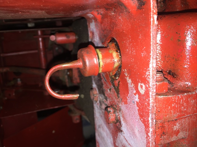

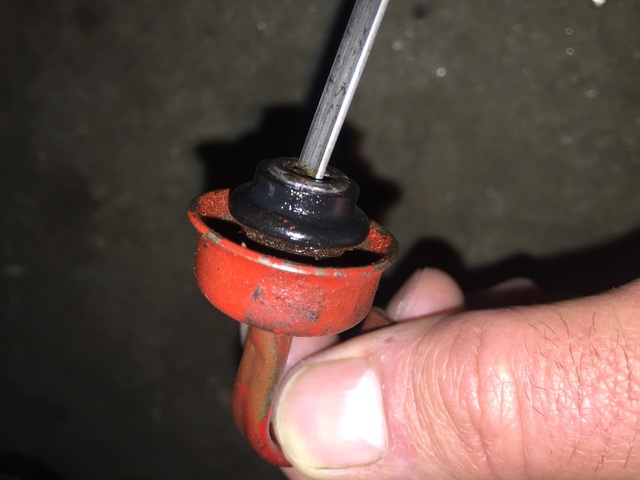

mikeeyre74 290 #1 Posted June 7, 2015 If you can see it in the pics there, my 8 speed unidrive transmission dipstick doesn't fit down on the.. Whatever you'd call that plastic piece that it's supposed to fit into to seal. The rubber seal is sort of flared out now and it just kind of rests on the top of the filler neck thing there. Clearly, this can't be right? But I can't figure out what's wrong with the dipstick.. Nothing seems to move or be anything goes other than just expanded out some how? What gives? Share this post Link to post Share on other sites
Racinbob 13,250 #2 Posted June 7, 2015 I'm not certain but I believe that should be an O-ring slip inside the fill tube. Share this post Link to post Share on other sites
gwest_ca-(File Mod) 12,519 #3 Posted June 7, 2015 It takes quite a hard two-handed push and turn to get mine in. From what I remember it looks the same as yours.A twist is also required to pull it out if it has been in for a while.Garry Share this post Link to post Share on other sites
doc724 927 #4 Posted June 7, 2015 Put a small internal bevel into the dipstick tube as a lead in for the seal. Also, make sure the seal is lubed with oil. If it is dry you will never get it in! Share this post Link to post Share on other sites
Pollack Pete 2,273 #5 Posted June 11, 2015 Just had the same problem with my new to me C-175.I pried the round rubber part out of the dipstick and very gently touched the raised portion to my grinder wheel.Put it back in the dipstick and now it fits all the way into the tube . 1 Share this post Link to post Share on other sites
mikeeyre74 290 #6 Posted June 11, 2015 You ground down the *rubber* part?? Share this post Link to post Share on other sites
pacer 3,181 #7 Posted June 11, 2015 FWIW - that is evidently a quite common problem. I know all of the tractors I have are this way to one degree or another, some will go in with a firm push and others dont want to go in at all. Some day?? I keep telling myself, I'm gonna try and find a solution! I like Petes solution, I think I'll have a go at that. Share this post Link to post Share on other sites

wallfish 20,723 #9 Posted June 11, 2015 Remove the plastic tube from the trans and drill into the dipstick end with a Unibit to remove just a little bit of material. I've done this quite a few times and also do this to shorten the tubes for custom tractors where the long tube won't fit. Share this post Link to post Share on other sites
