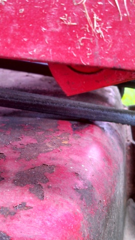

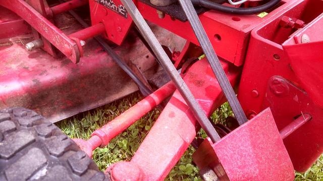

djohn24 10 #1 Posted June 6, 2015 (edited) My question is...Are all mowing decks compatible with each other in the 500 series? I have a 93 or 94 (dont know,tag was removed) 520H that had a 42inch RD deck on it. I also have a 516H with a 42inch SD deck. The 516's engine is in the process of being rebuilt. I put the 42inch SD on the 520 and it didn't attach near as easy as the RD deck. Had a little bit of a struggle getting it to hook up in the tach-a-matic. Then I noticed with the mule drive turn all the way in. the belt was already kinda tight. Hardly had to adjust the mule drive out. I mowed a few passes with it and seemed to be okay. It looks like the belt to the mule drive is rubbing on the deck. Thought maybe someone could jump in here and give me some info. Thanks in advance! Edited June 6, 2015 by djohn24 Share this post Link to post Share on other sites

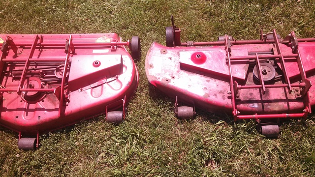

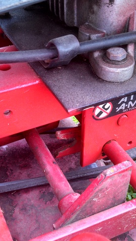

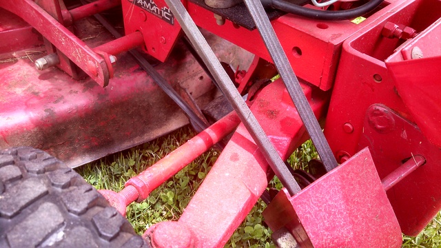

djohn24 10 #9 Posted June 7, 2015 Here are a few pics. Knowing now that there are different belts for each deck, should solve the belt on the deck issue. No problem with deck wheels hitting the back tires here. I just question how difficult it was to hook it up into the tach-a-matic v.s. the RD deck. The SD deck that came from the 516H did not have the bar on it that hooks into the tach-a-matic. I had to remove the one from the RD deck. Thought it may have something to do the 516 being a manual lift. If you notice in the one picture, I could not get the fork on the bar that hooks into the tach-a-matic to rotate up and lock on the bar in the tach-a-matic. Thank you to everybody jumping in here and giving their input! Share this post Link to post Share on other sites
Racinbob 13,046 #10 Posted June 7, 2015 (edited) You're good with a 60" with that axle. You definitely need to get that to get that fork positioned properly. Edited June 7, 2015 by Racinbob Share this post Link to post Share on other sites
oldredrider 2,553 #11 Posted June 7, 2015 Proper location of the fork will prevent rhe belt rub problem. When it is positioned correctly, clearance issue is solved. Share this post Link to post Share on other sites
Racinbob 13,046 #12 Posted June 7, 2015 Exactly. It will drop the deck down so it will clear. Share this post Link to post Share on other sites

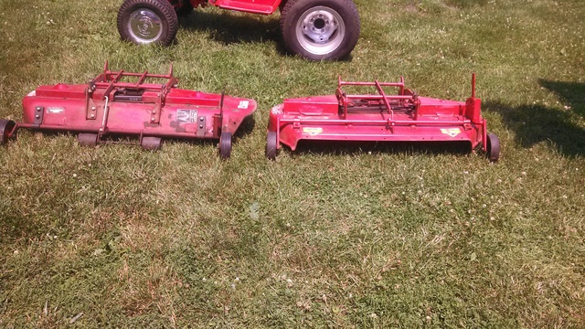

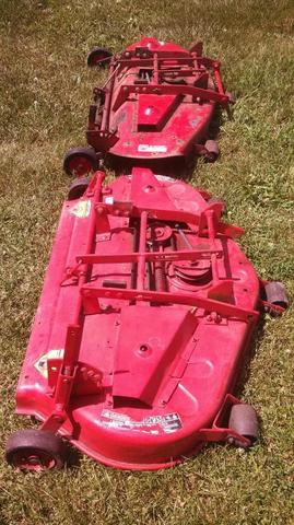

djohn24 10 #13 Posted June 8, 2015 (edited) I found out something today. I wanted to get that fork hooked up in the tach-a-matic properly. In order to do that, the deck has to move further back. Which. is where the longer belt to the mule drive will be needed. As Decksetter mentioned about his brother tried a 42SD on a 520 and the deck wheel rubbed the rear tire. I will have the same issue now. Didn't with the fork not being correctly hooked up. I measured outside to outside on both decks, the width of the deck wheels. The RD measured 44 1/8, the SD measured 42 1/8. Looks like i will have to add a spacer or something to move those deck wheels out on the SD. gwest_ca mentioned not seeing a 42 SD deck for the 520 North American model. I didn't know there was a export model. I'm still learning! Added a few more pics. Looks like the SD deck wheels naturally sit further back v.s the RD. Edited June 8, 2015 by djohn24 Share this post Link to post Share on other sites
Racinbob 13,046 #14 Posted June 8, 2015 Another member solved the tire rub issue by moving the deck wheel 'up' the bar a little which allowed for a little more clearance. However much it affects the deck was easily adjusted to correct but it sounded like it wasn't needed at all. Share this post Link to post Share on other sites
