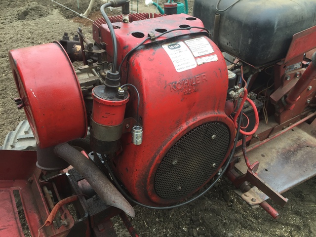

GlenPettit 1,719 #9 Posted June 5, 2015 Got and installed a new Kohler condenser (#230722-S, $22), but have not seen any improvement, now the C-160 will not run more than about 30 seconds before quitting, with or without the load/tiller. Double checked and cleaned all related systems I can think of, again. Something I forgot to mention is that the battery is dead and I have to jump it from my 312 each time to start it. Any chance the battery could be a factor, –– will get & install a new battery tomorrow. Again, any help, suggestions and advice is very much appreciated. Glen Share this post Link to post Share on other sites
squonk 47,374 #10 Posted June 5, 2015 Yes it could be related. I'm not sure with Kohler charging systems but on a lot of cars, if the battery voltage is too low, the alternator will not activate. 1 Share this post Link to post Share on other sites
rmaynard 17,422 #11 Posted June 5, 2015 You cannot run that tractor without a battery. If the battery is dead, the engine will stop. Try another battery. 1 Share this post Link to post Share on other sites
Racinbob 13,040 #12 Posted June 5, 2015 Yup, you found the problem. I'd suggest checking the charging system when you install the new battery. 1 Share this post Link to post Share on other sites

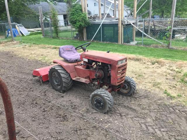

GlenPettit 1,719 #14 Posted June 7, 2015 OMG ! Everything works perfect now, since I installed a new battery,why did I wait so long (just trying to be cheap I guess), all I needed wasthis new battery to make everything work perfect, like it should.Got my garden tilled and 3 others all today, and I've been down since last summer.I sure got a whole lot smarter now, thanks to everyone.Glen 2 Share this post Link to post Share on other sites
