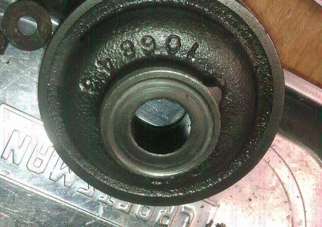

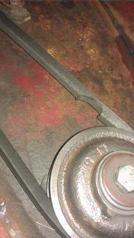

wholdguy 73 #1 Posted June 4, 2015 I need help, my first time trying to make repairs on a mower deck.Using this mower deck Model # 5-1001 on the 1970 Charger 12, it's been running very noisy and it's time to make some repairs.First problem is the # 94 6738 v-belt running the blades. It's cut and cracked and ready to break. Where can I buy this belt?Second problem is the # 15 5877 right blade pulley. The inner hole is rounded and doesn't hold the pulley, so it doesn't spin the blade. Where can I buy one?Third problem is the # 12 101480 upper bearings are loose and need replacing. Where can those be found? Fourth problem is the bottom shaft bushings are loose and need replacing. Where can those be found? Share this post Link to post Share on other sites

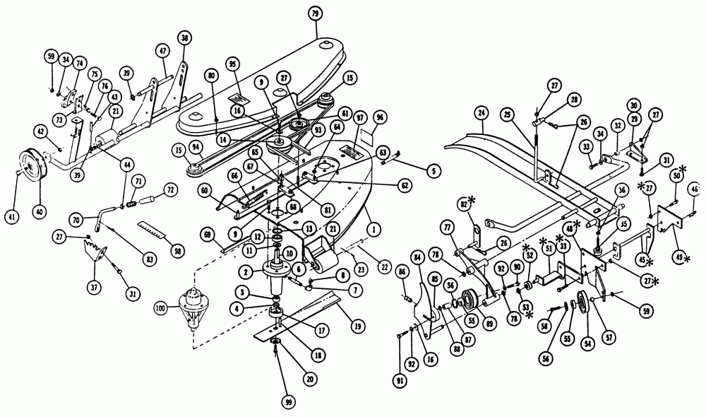

gwest_ca-(File Mod) 10,676 #2 Posted June 4, 2015 Here is a parts listhttp://www.wheelhorseforum.com/files/file/3046-mower-rotary-42in-sd-1972-5-1001-om-iplpdf/You can enter a part number here and if it comes up priced for Toro Consumer it should be available from any Toro dealer.http://www.partstree.com/parts/Your best and most economical source for bearings is an industrial supply, bearing shop or Napa. Post the numbers you need and we may have some generic numbers for them.An original Toro belt is usually the best buy.Garry Share this post Link to post Share on other sites
gwest_ca-(File Mod) 10,676 #3 Posted June 4, 2015 101480 may be generic # 1630-2RS but take the old one with you to make sure it is a match.Don't know what you mean by bottom shaft bushings.6738 is still a good number at Toro.Used pulley may be your best bet. The 2844 special washer should be replaced since the pulley failed. Should change them all.Garry Share this post Link to post Share on other sites

wholdguy 73 #7 Posted June 5, 2015 Shuboxlover -- I hope you can find the pulley for me, This mower is dead in the water without a pulley. My good pulley is marked 5877 . Is that what yours shows? You may send email to me at cleeko at tds.net. Thank you.Garry -- I will try that bearing number at NAPA. Thank you.G. Share this post Link to post Share on other sites

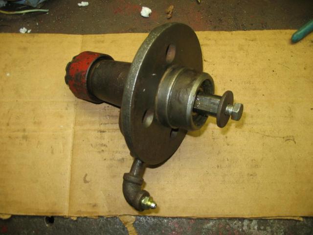

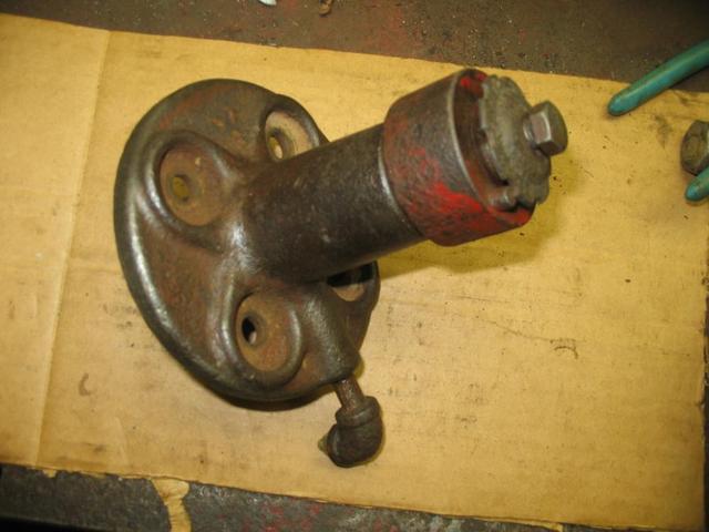

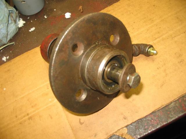

daveoman1966 3,653 #8 Posted June 5, 2015 (edited) I have ALL the pulleys, bearings, and drive belt you will need to repair this deck to fully functional. Red Sq is a great place to find parts and I find it MUCH EASIER to send pics and details back and forth using conventional Emails. To facilitate that, send me an OFF-SITE email so I can capture your email address, then forward some pics and details to you in that format. My direct email is:daveoman@windstream.netclik that link to send me a message with short note and I will make a prompt reply. ps...here is the schematic of deck 5-1001 BTW... Here is a COMPLETELY REBUILT spindle for this deck. It has NEW bearings TOP and BOTTOM, as well as a new grease tube and zerk in the top. Send me an email for more details.... I can probably rebuild the spindles you have with new bearings. Edited June 5, 2015 by daveoman1966 added info Share this post Link to post Share on other sites

wholdguy 73 #10 Posted June 11, 2015 The mower deck is finished tonight. I rebuilt 2 spindle towers, replaced a pulley, replaced a belt and sharpened the blades. Also replaced a broken zerk on a tower with a pound-in style. Then installed the deck back on the Charger and went out mowing to test it out. Cuts very well now and it runs so much quieter! This was a time consuming job, doing this for the first time, but next time will be so much easier.G. Share this post Link to post Share on other sites
