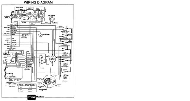

gwest_ca-(File Mod) 12,160 #6 Posted June 4, 2015 (edited) Fuses from the 1993-96 OM wiring diagramGarry Edited June 4, 2015 by gwest_ca Share this post Link to post Share on other sites
cheesegrader 436 #7 Posted June 5, 2015 Fuses are:15 amp light system-nearest steering column25 amp main fuse-middle30 amp charging system--farthest from steering columnPage 15 in the owners manual.Fuse blocks are a famous weak link. I've had to replace most of mine with individual, sealed fuse holders.I think Glenn Pettit sells a cover for the original fuse block to keep out the clippings. Share this post Link to post Share on other sites
