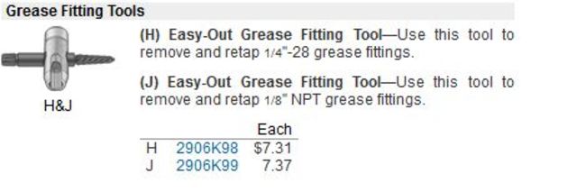

pfrederi 20,629 #6 Posted June 3, 2015 Auto parts store will have a zerk fitting tool. It has an easy out device on one end and thread restoration thing on the other with a wrench like thing to put in the new one. 6 Share this post Link to post Share on other sites
953 nut 66,430 #7 Posted June 4, 2015 If you already have a tire valve tool that looks like the grease fitting tool it should do the trick too. 1 Share this post Link to post Share on other sites
WH212-6 4 #8 Posted June 4, 2015 Great going to get one of those tools this weekend. Getting those spindle nuts off are such a pain. Think I am going to place the bearings with sealed ones. So I'll not have to worry about the grease there as much. Still should grease I assume? Share this post Link to post Share on other sites

cheesegrader 436 #10 Posted June 6, 2015 I've never seen that grease fitting tool. May have to get one.I have always been able to get these fittings out with E-Z outs. They are very soft.Be careful not to drive the removal tool in too far. Go slow.If you get carried away, you will drive the extractor right through the zerk and into the threads on the seat.Then the threads are ruined, little parts of the zerk end up everywhere,and you get to sing the "Bad Mechanic" song, full of magic words, with the accompanying "Flight of the Tools" dance! 1 Share this post Link to post Share on other sites
