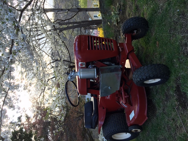

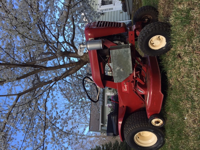

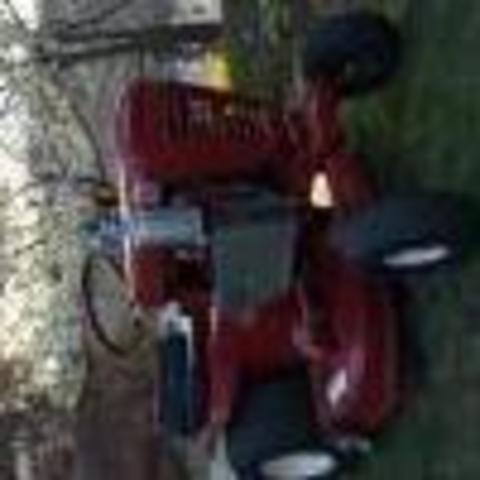

jzervas92 0 #2 Posted May 27, 2015 (edited) Also here are some pictures of my little ranger. I don't know why they're coming in sideways but the first two pictures (with the new muffler and belt cover I made) are after some TLC, and thelast picture is when I brought it home. Edited May 27, 2015 by jzervas92 Share this post Link to post Share on other sites
