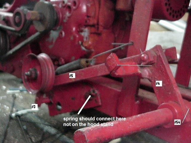

Beagles 72 #1 Posted May 22, 2015 anyone have close up photos of a front mount sickle on a 551?i just bought one and want to see how it mounts up.thanksdave Share this post Link to post Share on other sites
wallfish 20,515 #2 Posted May 22, 2015 You should have 2 triangle shape plates that bolt to the frame. Those hold the rear of the bar. Lift should be self explanatory unless you are missing the linkHere's a pic of the pedal set up on an RJ but is the same for all mid engine tractors. You can see the triangle plates but the bar is not mounted.The pulley to tighten the belt moves towards the rear of the tractor to engage the belt Share this post Link to post Share on other sites
