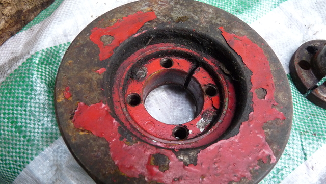

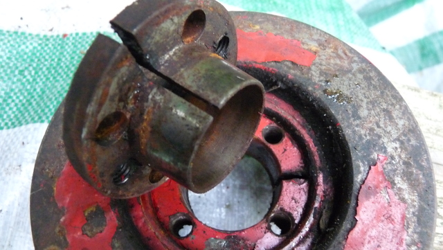

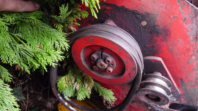

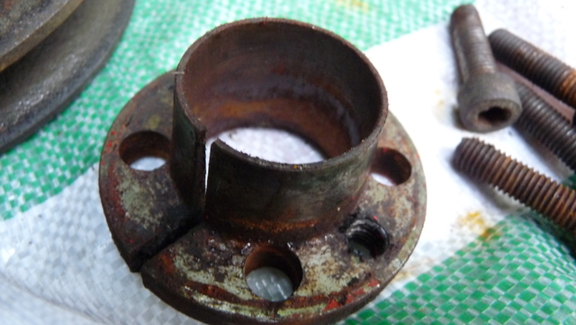

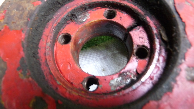

ranger 1,862 #6 Posted May 22, 2015 (edited) These pulleys are on one of my flail mowers, no keys anywhere, 11hp Honda engine.they work by the bolts forcing internal and external tapers together and clamping by allowing the slit to close up.Doug. Edited May 22, 2015 by ranger Share this post Link to post Share on other sites

ranger 1,862 #8 Posted May 22, 2015 Ranger, That is one of the few QD bushings I've seen with no key way.I know McMaster-Carr lists them but all the ones I have worked with were keyed.I assume the Honda engine has a keyed shaft.I forgot about taper locks when I replied but I still would'nt depend solely on a set screw to handle 10 horses. The Honda crankshaft is keyed, this pulley transmits the drive from the countershaft down to the flail rotor, I imagine there is no key to provide a chance for the pulley to slip if the rotor suddenly stops on fouling something. Share this post Link to post Share on other sites
