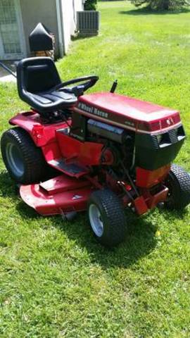

recman330 8 #1 Posted May 15, 2015 Looking at possibly purchasing a well serviced and maintained... 1986 16hp Onan powered Horse with a 46" mowing deck. Asking price is $775. I have 2 questions I was hoping someone could give me their view on. 1) Is this a fair price? (I believe its probably a good price) 2) Will my 76' B80 dozer plow and also slot hitch work on the new Horse? See attached pic, as I am not sure of the model name for this one. Thanks all for any help you can offer Share this post Link to post Share on other sites
Forest Road 595 #2 Posted May 15, 2015 Is that a 516? If so don't buy it. 2 reasons 1 - The Eaton 700 hydro is junk. They don't hold up nearly as well as the Eaton 1100. 2 - Personally I'm no fan of Onans. Too many well documented failures concerning the valve seats. For that price you should be able to find a Kohler powered 14 or 16hp hydro. Sent from my iPhone using Tapatalk Share this post Link to post Share on other sites
recman330 8 #3 Posted May 15, 2015 Thanks for the input...not sure of model...but from another picture it is not a hydro but a manual Share this post Link to post Share on other sites
Racinbob 13,122 #4 Posted May 15, 2015 (edited) It's really hard to tell from that picture and it doesn't expand well. I was thinking it was a 416-8 (8 speed) then you confirmed it with the post you just added as I was typing this It looks like it's in pretty nice shape. If it is nice and is good mechanically then I'd say that's a fair price. You'll find that to be a 48" deck, not 46". If the dozer blade was truly for a 76 B-80 it will work perfectly. I'd prefer Kohlers but I wouldn't shy away from an Onan. Edited May 15, 2015 by Racinbob Share this post Link to post Share on other sites
dcrage 636 #5 Posted May 15, 2015 According the the spreadsheet on "Wheel Horse Manufacturing in what years" an 1986 416-8 would be a Kohler -- 1989 was the first year for an Onan -- That would probably mean this tractor is 3 years newer than what you thought -- Or it got an engine replaced Share this post Link to post Share on other sites
Racinbob 13,122 #6 Posted May 15, 2015 Good catch Dave. I did think about that and looked at the D&A sheet but I had yet another gray hair moment and looked at the 96 Recman330, there's a tag on it that will have the actual model number on it (not the hood decal number). Any chance you can get that from the owner? In any case, the snow blade will still work fine. Share this post Link to post Share on other sites

boovuc 1,090 #8 Posted May 16, 2015 I blew the picture up and adjusted it somewhat. It is a 400 series and it is an 8 speed. Nice replacement seat on it. Can't tell with certainty if it is a Kohler or an Onan. I'm leaning on it being an Onan looking at the muffler and heat shield. The mower deck is a side discharge 42". Your B80 plow will bolt right up to this without modification if your B80 plow is a stock Wheelhorse plow for long frames. Share this post Link to post Share on other sites
Forest Road 595 #9 Posted May 16, 2015 What are we talking for a full valve job tho...$200?? That does seem overly costly. Get another 1000 Hrs? Just asking... Onans are famous for chucking valve seats. Especially on WH due to the placement of the belt guard. It's very common on the 20hp. Unfortunately it's typically not as simple as just doing a valve job. If it is an 8 speed it might be worth a look. The WH 516 w Eaton 700 was hydro drive with a manual lift. Lack of hydro lift is easiest way to tell difference between 1100 & 700. Sent from my iPhone using Tapatalk Share this post Link to post Share on other sites
ericj 1,580 #10 Posted May 16, 2015 if it was truly a 516 it would have the same dash tower as a 520 and this one surely does not, it has the 300, 400 style hood on it. everybody give the onan a bad rap. the valve seat issue is not really that big of deal to me. i can repair or have repaired a valve seat for less that $ 200.00 and have several motor done/ so i'll take all of your bad valve seat motors that you want to give me cheap because they're junk and repair them and have a good running motor. the majority of my heard is onan powered. onan failure is not a design failure as much as a lack of maintenance failure on the owners part. i've seen a lot of kohler singles blown up with holes in the block or spun and broken rods over the years, just make sure you keep the oil changed and proper level and blow and wash the block off regularly and the motor should be fine and i would recommend a compression test before buying the tractor although i have bought many and did not do the compression test till later eric j Share this post Link to post Share on other sites
