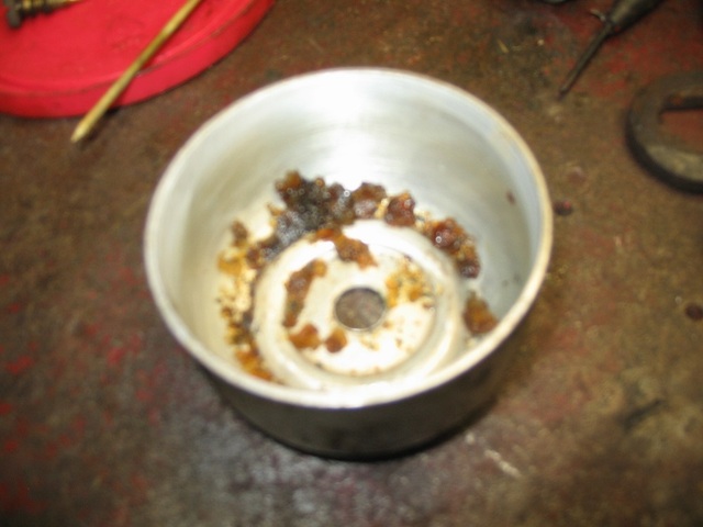

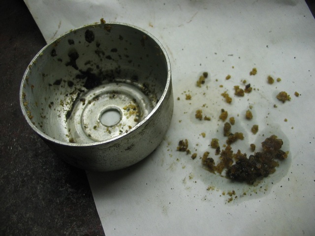

daveoman1966 3,882 #1 Posted May 13, 2015 I had just filled the tank to when my old faithful Bronco 14 with original K321s engine began acting up, as if it was starving for fuel. I had rebuilt the carburetor last summer / fall and it sat outside (under tarp) the whole winter and it didn't hesitate to start...about 1 month ago. Grimm thoughts of water or trash in the fuel tank overcame me. I have always used STABIL additive, knowing that ethanol gas breaks down in short term. Never did I suspect, or expect, to find what I found as the culprit... there was actually INDIAN CORN growing in the carburetor bowl. I think that STABIL was acting as fertilizer... Here is the PROOF...... INDIAN CORN for God's sake. Whodathunkit. Share this post Link to post Share on other sites

squonk 46,145 #4 Posted May 13, 2015 (edited) I haven't had the best results with Sta-Bil either. I have found the same thing when Sta-Bil was used only the particles were pink colored. I have had good luck with canned 4 cycle fuel that Lowes and other places sell for storage. My OPE dealer recommends the stuff. Not cheap but it has a 3 yr. shelf life. And my 2 cycles run awesome on the 50 : 1 they sell I also buy non -ethonal premium Edited May 13, 2015 by squonk Share this post Link to post Share on other sites

alswagg 128 #16 Posted May 13, 2015 What you found in your fuel bowl is not Ethonal, but in realilty stale fuel and varnish from years of build up on the inside of the fuel tank, lines, fuel pump and carb bowl. Ethonal is a from grain alcohol, alcohol is a great "cleaner" of the fuel system. What it does is loosen up the varnish from the metal tanks and lines. Then the bad happens, it gets sucked into the carb. We had many problems with this years ago with our customers boats. Add a good filter and change regulary. A few more tanks of fuel the entire system will be clean and easily run on Ethonal added fuel. Note only use up to 10 % Ethonal. Now the very bad, Ethonal since it is alcohol attracts water, is set and vented to the atmosphere it will naturally attract water and if enough water is introduced the molecules will seperate, This is called Phase seperation, you will get layers of water the lowest, then the alcohol, grey in color, then the poor fuel sitting on top. Just be careful and add fuel treatments such as Star Tron and change your filters frequently. Good luck Al 5 Share this post Link to post Share on other sites

305 380 #20 Posted May 13, 2015 i had the same brown crap in a used Honda generator i picked up...the fuel tank and the screen was very clean , just that crap in the fuel bowl. i blamed it on the ethanol fuel from the previous owner must have used. i use nothing but ethanol free fuel in all my small engines and cars. i do carry a bottle of Startron in all my road vehicles in case i get stuck using that corn gas 1 Share this post Link to post Share on other sites
