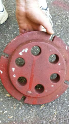

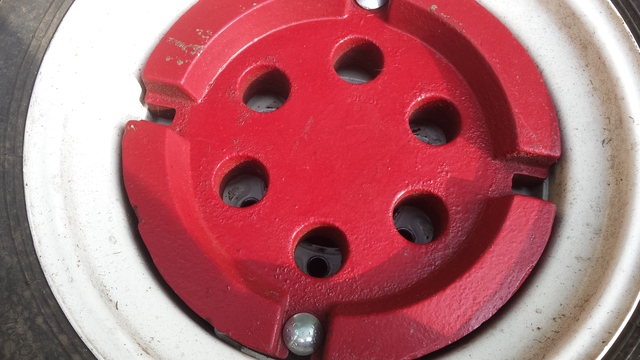

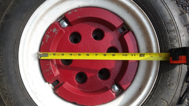

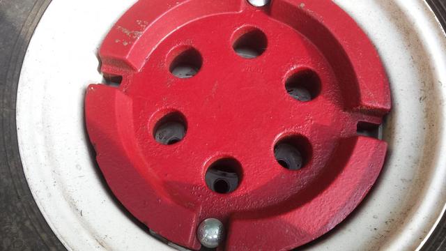

Trouty56 568 #8 Posted May 19, 2015 Well....I hope this helps you a bit.....the lip is 1 inch high.....guess they weigh about 60 lbs....maybe more/less.....2 inches deep at the access holes and bolt holes...bolt holes are wide enough to secure a carriage bolt12 inches across and fit inside the tire circle....... 1 Share this post Link to post Share on other sites

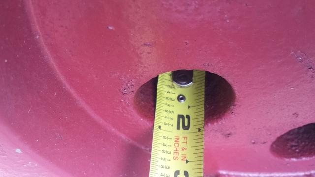

lawnboy63 18 #10 Posted May 19, 2015 Pics look great.Diameter of 6 holes, size of carriage bolts? Share this post Link to post Share on other sites
lawnboy63 18 #11 Posted May 19, 2015 Opppss, center distance of carriage bolts? Share this post Link to post Share on other sites
Trouty56 568 #12 Posted May 19, 2015 The holes are 11/2 inches in diameter....the bolt slots are 1/2 inch wide....10 inches between them.... 1 Share this post Link to post Share on other sites

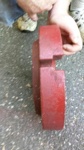

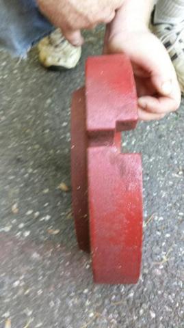

Trouty56 568 #16 Posted May 19, 2015 (edited) Ok,,,,the lips are 1 1/4 inches and taper to about 1 1/2....the front lip extends about 1 inch....the rear is 3/4......heck they might be the same......they are HEAVY..... Edited May 19, 2015 by Trouty56 2 Share this post Link to post Share on other sites

Trouty56 568 #21 Posted May 20, 2015 (edited) Bob, thanks for all the pics and info that you provided. I've got a meeting scheduled for Monday at the foundry. Just from the conversation I had with them their thinking cost for a weight of 50-60 lbs would be around $1 per lb. plus the cost of the pattern.After I talk with them I may decide to make my own pattern.Tom Looks like the indent on the top is more like an inch on that last photo......if you made it flush across you would probably gain 10-12 lbs..... Edited May 20, 2015 by Trouty56 Share this post Link to post Share on other sites
tbarnhart 240 #22 Posted May 20, 2015 The indents are cast that way so that the weights will stack and still be centered. You could put 2, 3, or more on each side if you had longer mounting bolts. I don't think I would make them flat, just get a couple more cast and stack them. 2 Share this post Link to post Share on other sites
Trouty56 568 #23 Posted May 20, 2015 The indents are cast that way so that the weights will stack and still be centered. You could put 2, 3, or more on each side if you had longer mounting bolts. I don't think I would make them flat, just get a couple more cast and stack them. I learned something today....thanks!!!! Share this post Link to post Share on other sites

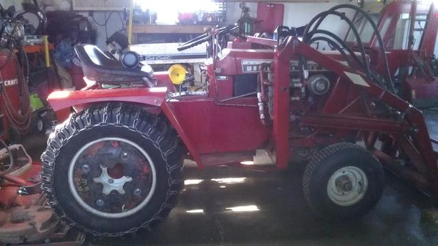

jeremi3210 747 #24 Posted May 20, 2015 Here is a pic of mine. Probably all of 60 to 75 lbs, I found them at the scrap yard for .25 a pound. I wish I could find more like that! 1 Share this post Link to post Share on other sites
