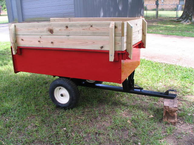

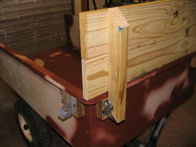

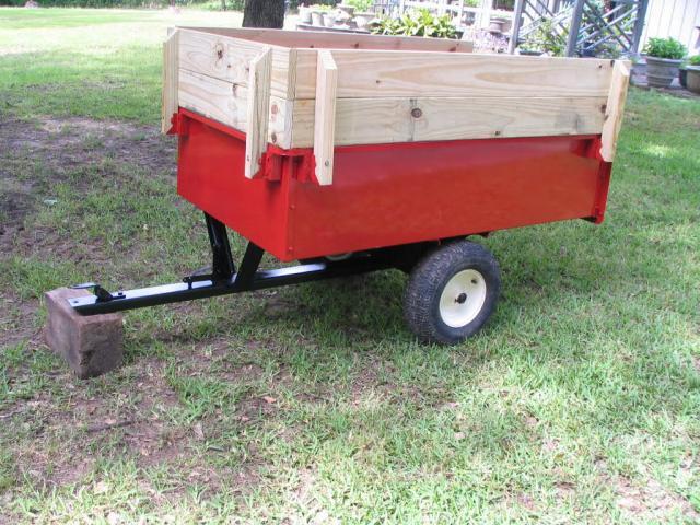

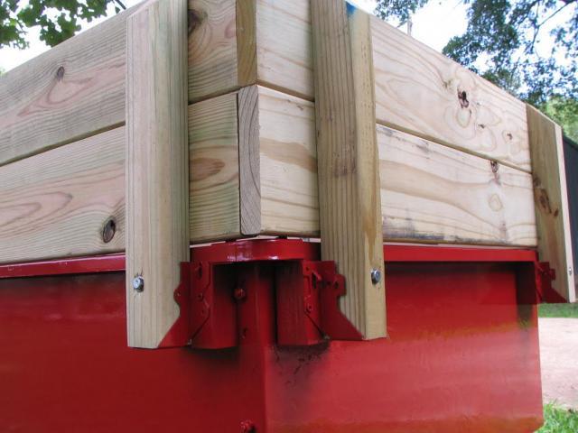

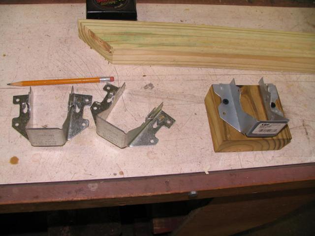

pacer 3,180 #1 Posted May 9, 2015 I have one of those 17 cu ft yard trailer/carts from the big box stores and that thing is worth its weight in gold for doodling yard refuse, but I've always wished it had a bit more capacity.... Sooo since I have had it several years and it was needing a 'freshening', I figure while I've got in the 'repair shop' I might as well try and add some to its capacity ability. Of course since it was needing paint it naturally was gonna some RED! put on it! I went to the H depot and looked at what was available, wanted something that was treated because the cart has to live outside and settled on round nose decking, a 2x6 for the uprights. and 6 of those handy support thingys. Construction was pretty straight forward - a drill, handfull of deck screws and a few lag bolts and --- by golly the dang thing looks pretty good! (Course that RED paint is what makes it look REALLY good) Think I just may have to get me a couple 'Wheel Horse' decals from Terry to top it off with.... Thought you guys would like it too and maybe get ideas for your cart.... 14 Share this post Link to post Share on other sites

953 nut 69,812 #5 Posted May 9, 2015 ​Looks great, now you can really work hard! Hope you flattened the edges of those little saddles, they are so sharp that they will reach out and grab you as you go by. Share this post Link to post Share on other sites
