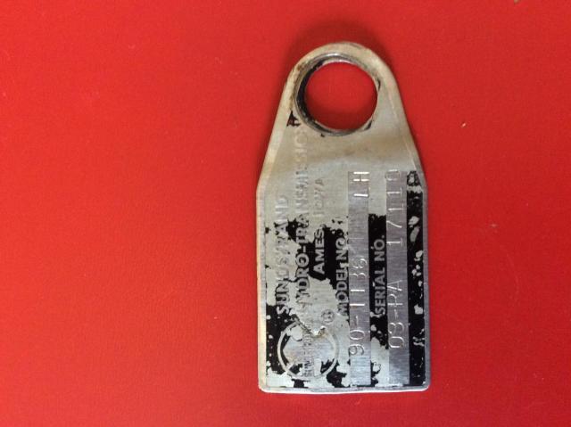

gwest_ca-(File Mod) 12,519 #2 Posted May 9, 2015 Was going to try and look them up but discovered the 90-1136 was used in the 12hp and 14 hp models. The C-160 shows as using 90-1140. Has the transmission been changed or are you getting the 90-1140 off the ID plate? Garry Share this post Link to post Share on other sites

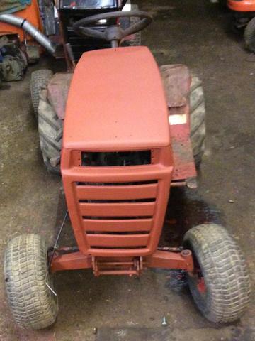

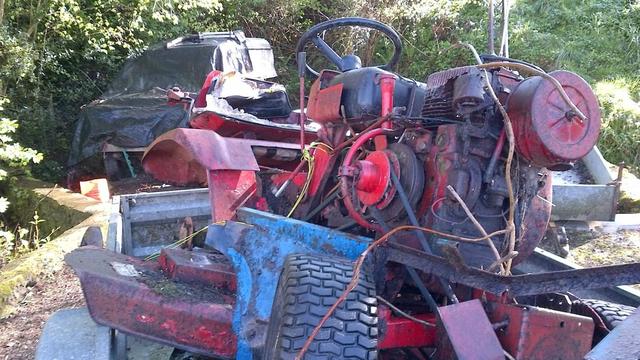

Welsh Wheelhorses 8 #3 Posted May 10, 2015 Here is the id plate. I do not know the history of the c160 because I got it out of a bramble patch! As you can see it was a bit worse for wear when I got it. I am slowly pulling it in to shape now but it's taking awhile. 2 Share this post Link to post Share on other sites
Racinbob 13,250 #4 Posted May 10, 2015 Wow! Most folks would have considered that a parts machine but you decided to save her. Outstanding! Share this post Link to post Share on other sites
