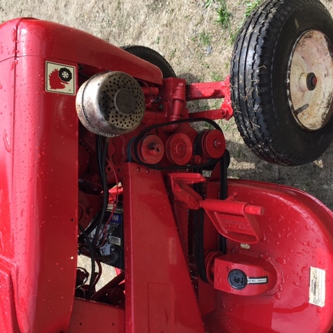

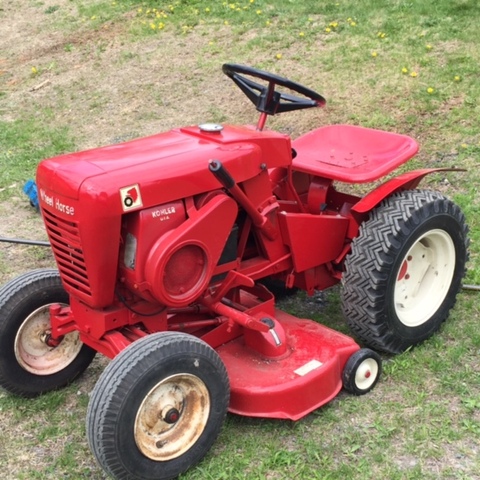

Tyler88 31 #1 Posted May 4, 2015 First timer here. Recently purchased a 702 for my son and Im trying to figure out how to engage the mower. I have attached a pic to see if you guys can help me determine if that is the right belt, also included a pic of the machine. Also, any ideas where I can get extra hood thumb screws, lost one today. Lastly, would love to find a plow blade, is there a certain model/size I should be looking for? Thanks so much for the help and I look forward to trolling the forums educating myself. 2 Share this post Link to post Share on other sites

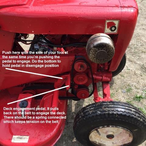

gwest_ca-(File Mod) 12,533 #2 Posted May 4, 2015 Welcome to the forum. Nice tractor. That drive belt looks to be too long - should be 28". There is a lock lever on the pedal that rests on a roll pin. Push the lever so it pivots and leaves the pin and the spring should pull the idler pulley back to tension the belt. The way the spring is connected to the lock lever should reset the lever against the pin when the larger pedal is pushed to release tension on the belt. Mower manual Tractor manual Garry Share this post Link to post Share on other sites

gwest_ca-(File Mod) 12,533 #5 Posted May 4, 2015 Guys, Also do any of you guys know which belt is needed for the pto to the deck, a part #. Thanks, Will The drive belt is WH #1577 replaced by Toro #7430 The matched pair of #1578 belts are still available from Toro under the same number. Garry Share this post Link to post Share on other sites
