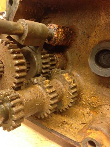

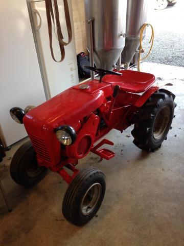

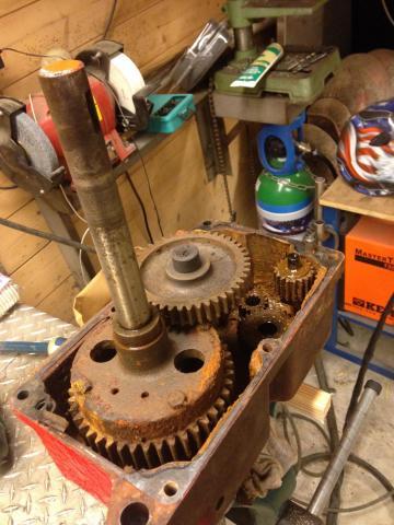

Kamasan 5 #1 Posted May 3, 2015 Hello, My name is Ole, I'm from Norway I have bought my first Wheel Horse this week, I think it´s a 753, but I'm not sure... Ser. no: 62-12359 Engine: Kohler K 161 S 589172 2.8626E Transmission: Uni-drive Pat no 2988185 My case is that there was water in the gearbox. I opened it, and figured out that I need all the bearings inside and the seals new, and also a new gear. (One of the gears was damaged.) If anybody knows how i can get these parts,I will be very pleased. Ole 1 Share this post Link to post Share on other sites

stevasaurus 23,716 #4 Posted May 3, 2015 Ole...Welcome to Red Square. Send a PM to Lars like was stated above...he just may have what you need, and he knows a bunch of us on this side of the pond. You took the wrong side of the trans off...upside-down. Should have taken the deep side off and left the gears in the shallow side...it is OK. Clean everything up and take pictures and we can set you up. Share this post Link to post Share on other sites
groundhog47 448 #5 Posted May 4, 2015 (edited) Ole to . Not an expert like Steve stevasaurus, but from what I see your gears look good except for that 1 spot on cluster gear. In the transmission section of forum Steve has an excellent spread sheet of bearings and seals ( ) which is the biggest probable failure with water intrusion. The main carrier bearing (hopefully not completely eaten up) is no longer manufactured. Some members on here from time to time have some used. May luck be with you on the gears. In case you have no manuals, here is a free download supplied by Admin that covers from 1958 to 1982 transmissions. Edited May 4, 2015 by groundhog47 1 Share this post Link to post Share on other sites
