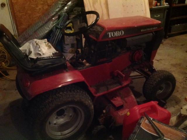

cmitch 3 #1 Posted May 3, 2015 My mother asked last week if I could get old faithful running. Battery was dead so I replaced it. It cranked right up and ran flawlessly for about 45 seconds, then it sputtered and died. Later attempts to start showed gas was literally spraying out the top of carburator. I removed carborator to unstick float and needle. Freed it up, reassembled and it fired up after about 3 start attempts. It ran beautifully and I mowed over an acre of grass with it when it just sputtered and died while mowing. I thought I had run out of gas but tank was half full and fuel filter had fuel in it. Attempts to start even after checking carburator again was fruitless. Getting fuel but no spark. I noticed this model has an electronic ignition coil pack with the plug wires feeding out. Is this a known problem and what is the proper way to check this part for proper voltage? Thanks! Share this post Link to post Share on other sites

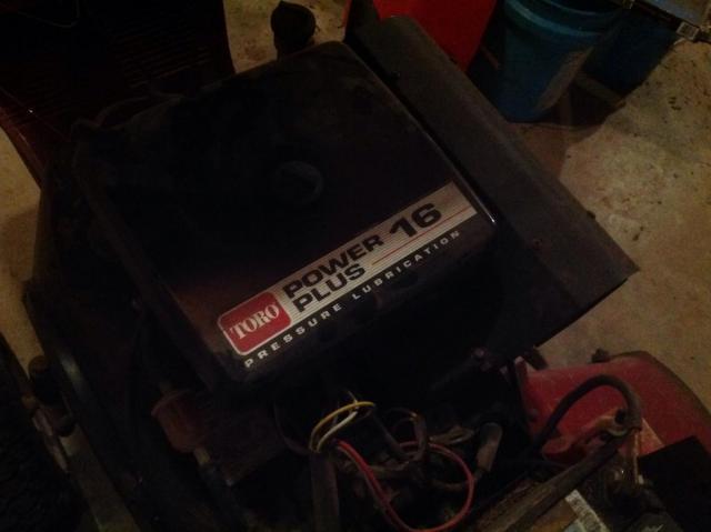

cmitch 3 #3 Posted May 3, 2015 (edited) Here's a pic of the engine with breather cover: Edited May 3, 2015 by cmitch Share this post Link to post Share on other sites
Theroundhousernr 590 #5 Posted May 3, 2015 That's an onan twin cylinder. Not a Kohler. The wiring can be temperamental. Check fuses and fuse holders for corroded terminals. Also there is a white nine pin plug that is responsible for every connection to the motor besides the ground. Be looking for the same thing, corrosion. Check your safety switches, your pto must be disengaged to start. If you find everything ok mentioned above, you will have to move onto checking coil and ignition module. Which I will get into after you check the other stuff. Oh and check for twelve volts at the positive side of the coil to ground when key is set to run. Start there first. Kyle Share this post Link to post Share on other sites
cmitch 3 #6 Posted May 3, 2015 (edited) All paperwork I've found including owner manual says it's a Kohler engine. It was purchased Dec. 1993 for $3830. Model # 416-8 31-16O84. Serial # is 2000594. I think he may have gotten the wrong manual with the mower. Obviously, all pics check out to be an Onan. I'll see if I can get better pics of the engine. Thanks. Edited May 3, 2015 by cmitch Share this post Link to post Share on other sites
Theroundhousernr 590 #7 Posted May 3, 2015 (edited) 110 percent positive you have a p216 onan performer series twin cylinder 16 hp engine. Kolher made a 16 single magnum but that's not your engine. Edited May 3, 2015 by Theroundhousernr Share this post Link to post Share on other sites
gwest_ca-(File Mod) 12,276 #8 Posted May 3, 2015 Here is your operator manual Garry Share this post Link to post Share on other sites
cstempert 27 #9 Posted May 3, 2015 16= 16Hp O = Onan 804 = 416-8 Usually terminals are corroded or loose. Check the module for loose connections 1 Share this post Link to post Share on other sites

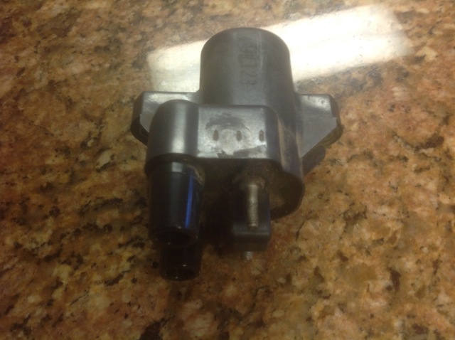

cmitch 3 #13 Posted August 24, 2016 (edited) My mother had decided she wanted to hire mowing done so I abandoned working on it and put it away. Now, she's decided she wants it fixed. I told her the issue was no spark and have since 'edumicated' myself on this mower. OHMS across poles of coil reads 1.9. I know it should read 2.9 to 3.6 per another thread here. A small engine service guy checked it and he said it seemed the ignition coil was bad. So, I'm carrying it home to my place and going to get to work on it, get it running and mow some grass. When it was running, it was the smoothest machine I ever used. Deck was quiet but that may be because I rebuilt it with new spindles. Thanks for all the manuals. I downloaded and printed them. Edited August 24, 2016 by cmitch Share this post Link to post Share on other sites

cmitch 3 #15 Posted August 26, 2016 Went ahead and removed ignition coil. Tested it myself and got only 2 ohms. It would start off at about 2.2 then fall back to 2. Share this post Link to post Share on other sites
