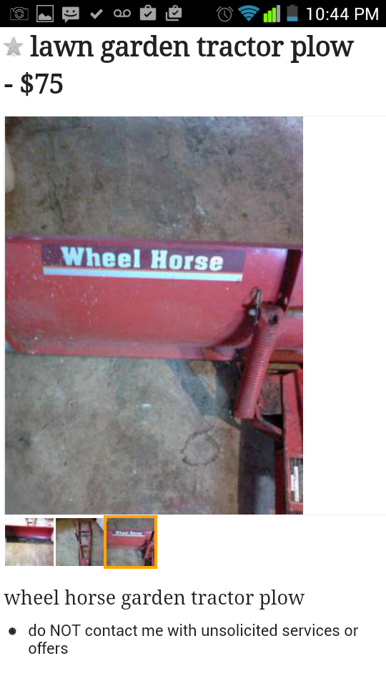

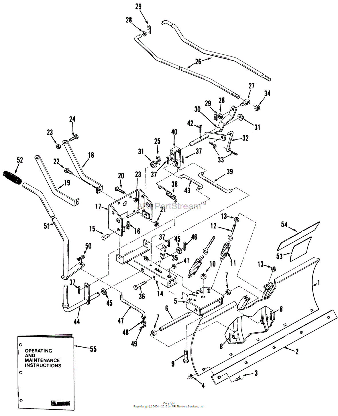

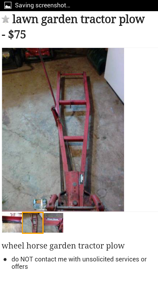

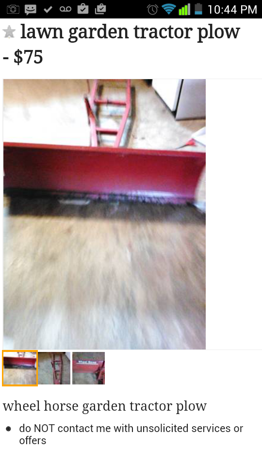

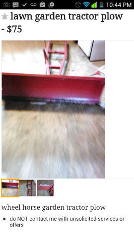

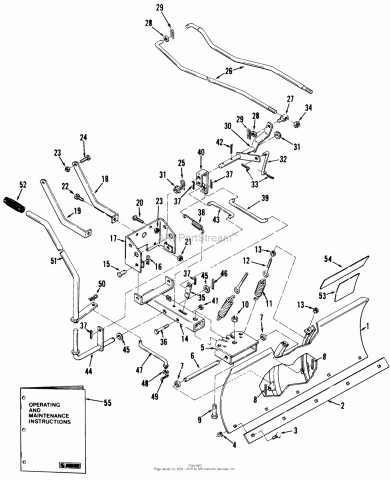

daveoman1966 3,884 #2 Posted May 1, 2015 The dozer blade in your pics will NOT work on the B-111. You need to find a dozer blade like the one in this schematic. The model numberfor the B=111 is 06-42BB01... (thru 06-421BB05). The dozer blade in your pics will fit B C 300 400 500 tractors with Horizontal shaft engines. There is a world of difference. Share this post Link to post Share on other sites
