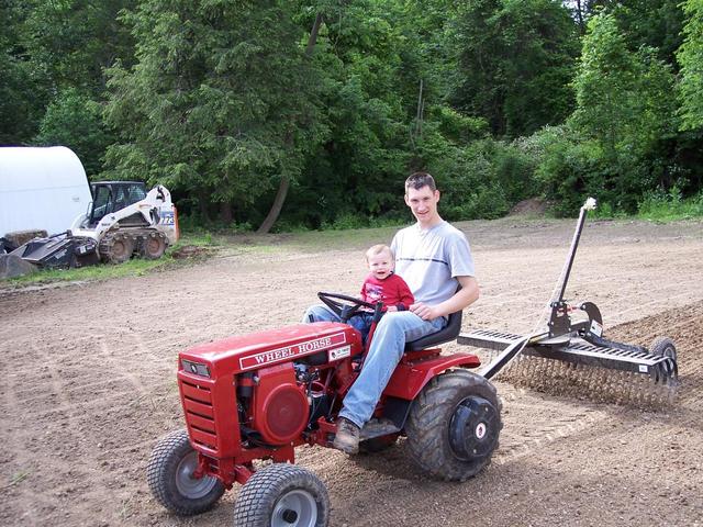

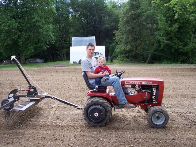

stevebo-(Moderator) 8,741 #3 Posted May 2, 2015 I am pretty sure it will work. Here is a pic of one done. This has 520 rims with 10.50 ags on back. This tractor is not mine however it will be soon. Share this post Link to post Share on other sites
tbarnhart 240 #4 Posted May 2, 2015 Thanks for the pics, Steve. The tractor I'm looking at has 10.50 carlisles on it but the rims are rusted pretty badly from calcium. They aren't original to the tractor and aren't wheel horse rims at all. The valve stem is on the outside, and the centers appear to have been moved and rewelded with more offset. I could just get any 8.5 in. wheel and cut them apart, set them where I want and weld them back, but I was trying to save the work and get something that would just bolt on. If you get the tractor, I'd be interested in knowing how much clearance it has between the brake and the left wheel. Share this post Link to post Share on other sites
