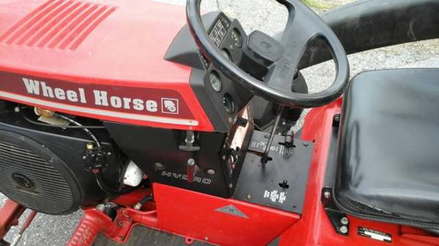

tsmall07 49 #1 Posted April 29, 2015 It's billed as a 520H and it has 520H on the hood, but my 520H doesn't have the stick going into the floor in front of the seat. That looks like a gearshift lever. Is it a manual trans model with hydro lift? Thanks in advance. Tyler Share this post Link to post Share on other sites
scotty 252 #2 Posted April 29, 2015 (edited) Ive seen a few 520hs with the motion lever on floor. Should also be a lifting lever nearby if i remember correctly Edited April 29, 2015 by scotty Share this post Link to post Share on other sites
Bert 804 #3 Posted April 29, 2015 I believe its an 88 or 89 520H, the 90 and up had the motion control on the column. That pic is just the older style hydro control. 2 Share this post Link to post Share on other sites

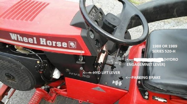

daveoman1966 3,882 #4 Posted April 29, 2015 (edited) This is either a 1988 or 1989 Model 520-H with the motion control lever protruding from the middle cover plate. The hyd lift lever is on the left side as in theis pic (your pic). There is also a Hyd engagement control lever. not to be used for a PANIC STOP. PARKING BRAKE... the little tab on the tunnel cover plate (as corrected by another member). ps... If you want to UPGRADE to the later model style with the control levers on the steering column, I have the parts to do that from a 1995 model that I parted out a while back. contact me here: daveoman@windstream.net Edited April 30, 2015 by daveoman1966 1 Share this post Link to post Share on other sites

Theroundhousernr 590 #7 Posted April 29, 2015 (edited) That is the hydro engagement lever in your pic, however, it is no parking brake. The parking brake is the little tab to the left. You depress the pedal and flip that up like most other wheel horses. The tractor will roll away after some time unless the brake is put on. This is either a 1988 or 1989 Model 520-H with the motion control lever protruding from the middle cover plate. The hyd lift lever is on the left side as in theis pic (your pic). There is also a Hyd engagement control lever...aka Parking Brake. ps... If you want to UPGRADE to the later model style with the control levers on the steering column, I have the parts to do that from a 1995 model that I parted out a while back. contact me here: daveoman@windstream.net Edited April 29, 2015 by Theroundhousernr Share this post Link to post Share on other sites

shallowwatersailor 3,221 #9 Posted April 29, 2015 I use to own an '89 and a '90 520-H. In my opinion, the motion control lever on the '89 (like the one pictured) with the motion control between the legs was easier to operate as opposed to on the steering column. 2 Share this post Link to post Share on other sites
